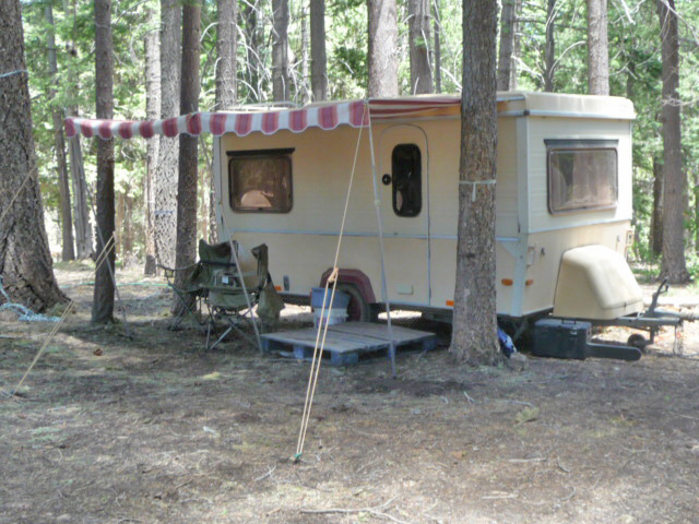

Spent another three nights in the Esterel on the mountain, this time it got down to 29 degrees at 6AM, into the low 60's during the day. Snow lingered in very few places, and none in camp.
Discovered the furnace works using the converter, but not on battery. Where we are camping power is supplied by a large diesel generator, which is turned off at night. A bit nippy by the time AC is restored! Suspect the problem is low voltage to the furnace (which has electronic ignition, no pilot) due to too-small wires from battery; the blower works, but no flame.
We stayed pretty warm, though, and much more comfortable than when surrounded by canvas! Despite the wind hitting 32mph, no breezes got through, and the trailer never felt unsteady.
Major issue: The rear dinette converts to a full-size bed, which is what we used; the power convertor is under it, against the rear wall In order to change from shore power to battery, you have to flip a switch on the convertor, which is really hard to reach! On your knees, with a flashlight and a pole to extend your reach... Also, the convertor does not charge the battery. Will be replacing that thing with an automatic-switching unit that has a built-in charger. (And put in larger wires from the battery.)

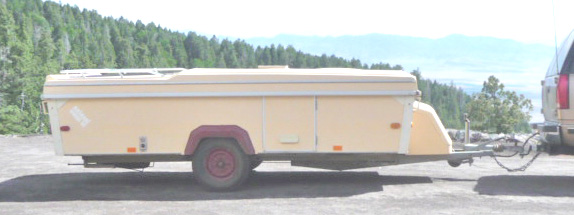

The first photo shows a profile of the trailer, where you can see how low the tongue is, just ahead of the door. Also note the spare tire under the rear. We're going up again next week, for eight days, and will get some "lived-in" interior shots then.

Trailer was great for the eight-night campout, especially with just two inisde. This time the temps were into the low 70's during the day, upper 50's at night. After getting home, I started reworking things...
Took out the convertor it came with and moved a newer electronic model to the other end of the trailer, where it will be accessible. Added a circuit distribution center, a combo 120/12 breaker/fuse box I found on eBay. Also moved the power cord to be stored next to the convertor.
Moved the furnace to under the front seat, to free up the space under the bed. It's a Duo-Therm, so there was just a small hole to cut in the side for the vent.
Ordered a pair of 11.75" x 40" cargo doors off eBay and put them in on each side, under the bed. Now that space is very easy to get to to store chairs, the awning, etc. Took out the rear dinette and made a matress support to fit, using plywood and some square aluminum tubing. Even got permission to take out the "kitchen" cabinet (sink/cooktop/fridge). Not sure what I'm going to put in its place, but it will be just storage, as cooking is done outdoors.
The suspension is just bolted on, so I'll put a 2" square tube between it and the frame to get a bit more clearance, and not mess with the tongue. In two weeks we take it up a narrow, twisty dirt road for a three-day outing, we'll see how it does on that road...

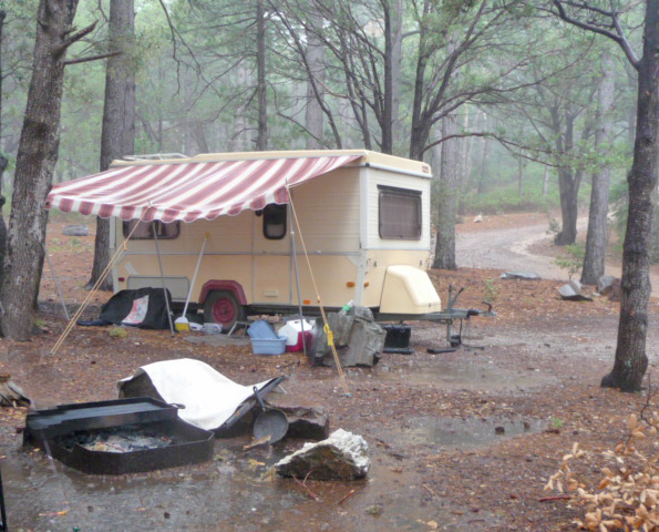

Still no shots of the inside, never think of it when we're using it... Pulled the trailer over 2,000 feet up a swithbacking road, no probelm at all. The long tongue helps out on those hairpins.Weekend went well, rained a bit every day, one day for over two hours. No leaks! In the photo (taken during a downpour), you can see one of the cargo doors. They were very handy, well worth adding. The awning is set low so it would not hold puddles.

That cargo door is sweet! Do you have the name of the Ebay user that you bought it from? If you ever decide to remove the hanging lights, I would be interested in buying them. Thanks! LuAnn

I found the cargo doors on Ebay, I guess I should ask you the depth of the one that you purchased, and what you used to cut the hole in the side to accept it? You appeart to be very handy at all this, obviously, I am not. LuAnn

The doors are from 'willisdlr', or search for 'pewter cargo door' (pewter being the color). The size is 40" x 11.75", which will fit under the existing seating. They are good-quality doors, with radius corners and rubber seals. You would have a problem with the seat supports being in the way, but since I re-worked the whole rear end, they were not an issue for me.
I cut the holes using a jigsaw (sabre saw) with a fine-tooth blade. The walls are bonded fiberglass/styrofoam/plywood, and cut quite easily. There are 1x2's about every 2' in the wall, a bit tougher to get through but not a problem. Mine ended up with the rear of the opening being along the edge of one of the 1x2's. Put tape on the bottom of the saw to prevent scratching/marking the fiberglass around edge of opening.
