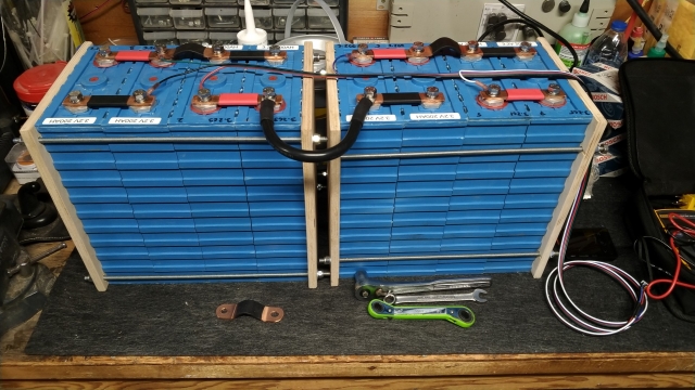

bdosborn wrote:About this big:

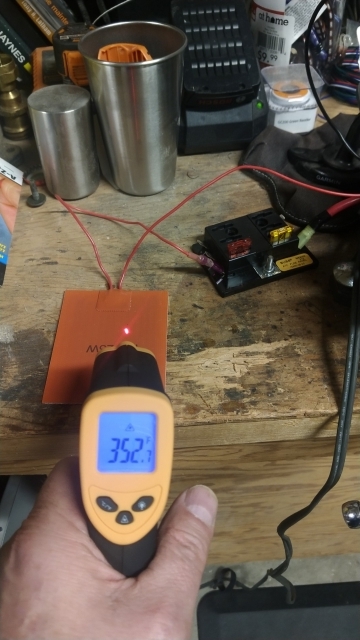

12 Watt heating pad will consume 288 watts in 24 hours or 24 amps running continuously ( my edit, unless you total for the day, which I think you do ) . Major assumption here based on nothing - If the heater runs s 50% with a thermostat in 24 hours it would consume 144 watts or 12 amps. leaving 576 watts or 48 amps of power for consumption.
