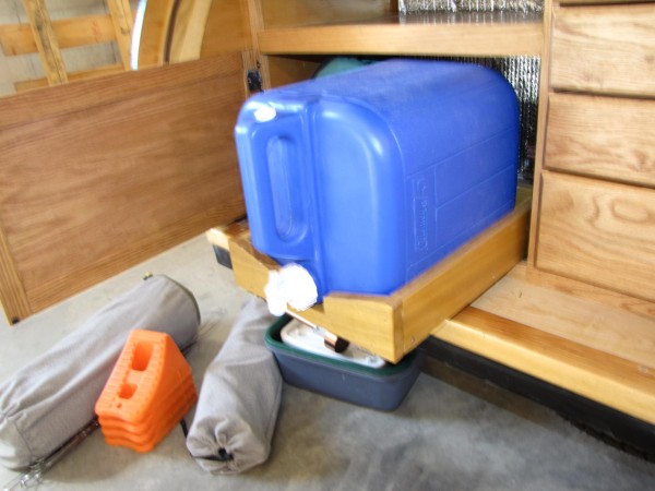

I'm in the early stages of planning my teardrop trailer, and this forum has been incredibly helpful. I'm considering incorporating a dedicated area for a water container in the galley. I'm thinking of placing an Aqua Tainer on its side to fit my layout, but I'm concerned about the risk of water leakage—up to 4-7 gallons from the cap or spigot—especially since the trailer will navigate rough fire roads with potential for significant jostling. Traditionally, these containers are transported upright, but that orientation doesn't work with my design's height restrictions. My solution is to mount it on a locking slide mechanism for easy access and water dispensing. Do you think this setup could lead to leaks, or is it a viable solution?

I have a very similar set up. It has leaked (always my fault-failture to close it tight enough, leaving the air vent open). My solution is to epoxy the bottom of the tray so it is not damaged by water. Been working for 15 years. Image
