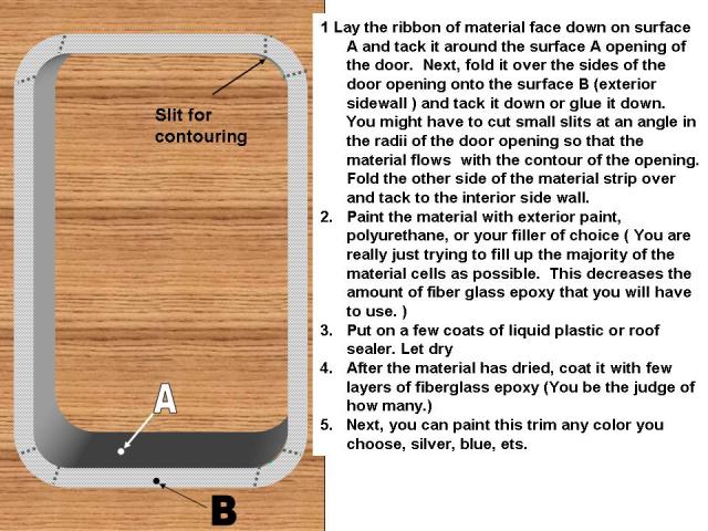

I am using a recycled material that I cut into 3" wide strips, 25 feet in length with a straight-edge. Because it is material it is easily shaped around curves and it can be attached with a construction adhesive and a stable gun. I put a overcoat of that rubber undercarriage coating (or you can use liquid plastic, Plasti-dip, sold at Lowes). I will coat the trim in the door ways with fiber glass. I plan on painting all of the trim silver when I am done. The paint should handle the UV issue.
This way may be a little more work, but it is inexpensive, allows me to have a continuous trim from front to back, and I don't have to anneal or bend anything. I haven't trimmed everything yet, but thus far, I have been pleased with the results.

Postby Ira » Mon May 22, 2006 9:46 am
Todah--can you give me a short idiot's guide on doing the door openings in fiberglass?

Postby Todah Tear » Mon May 22, 2006 12:30 pm
Okay Ira, I'll take the bait (I'm not certain whether you are teasing or serious :)
I have tried this in the galley area. I haven't gotten to trimming the doors yet. I have been struggling with the hatch shape for a week.
Nevertheless here it goes:
Later you can cut out any holes that you need for mounting hardware or locks.
The door trim can be done in the same fashion.

Postby Ira » Mon May 22, 2006 1:21 pm
I AM serious, but in step one, what do you mean by "ribbon of material?"

Postby Todah Tear » Mon May 22, 2006 4:19 pm
Ira,
The "ribbon of material" refers to a 3" wide strips that I cut from a roll of mat/cloth type material (It is made of recylcle something or the other.). The cloth is taking the place of the regular expensiver fiber glass cloth; it was left over from what I used in my inner walls. I imagine any type of absorbant cloth or cloth-like material would work (like the material that they make the handi-wipe towels for paint jobs).
I hope that answers your question.
