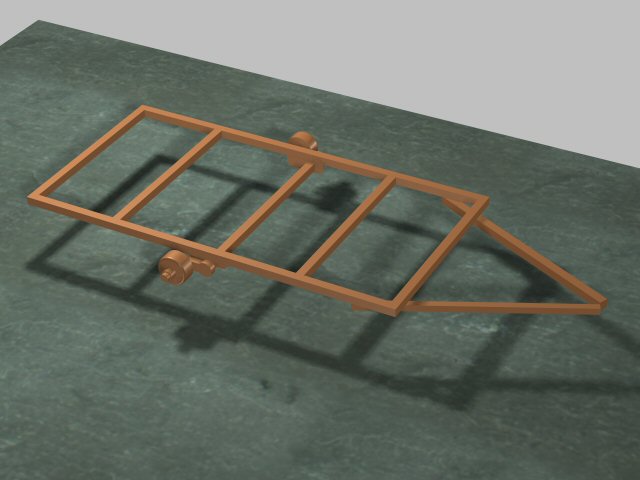

George, so here comes the instant estimate for a 5x8 trailer based on Mike's Baja Benroy:
926" of 2x2x1/8 tube 237lb
Axle #9 Dexter (2200lb capacity) no brakes 68lb
Wheels 175/70x13 29lb each
coupler 7lb
fender (steel, round) 6lb each
paint, weld, lights, chains, etc, say 5lb
Grand total 387lb
If you wanted to go lighter, but still at least as strong as the HF, you might get something more like:
less steel tube, say 150lb
Axle #8 Dexter (1100lb capacity) no brakes 53lb
wheels 5.30x12 24lb each
coupler 7lb
fender (smaller) 3lb each
Grand total 266lb
