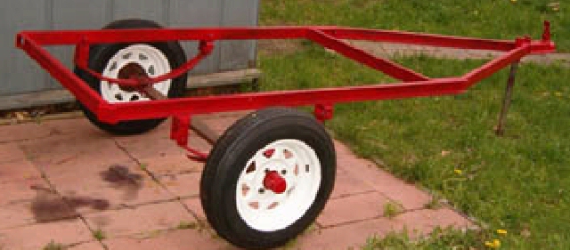

Hey there Mr Wild!!!
I just eyeballed your trailer,
http://tnttt.com/album_ ... ?pic_id=94
and it seems like it's really high off the ground. Is that the plan? Are you going to build some kind of rocking hopping desert rat of a teardrop?
So tell me. Grab a tape measure and tell me what's the distance from the ground to the underside of the frame?
I did notice the axle is bolted underneath the leaf spring. You could take the axle and move it above the leaf spring. A lot of us "Harbor Freighters" have done that.
What's the length of the siderail? Is that a full 8'? And while you're at it, how wide is the trailer?

I was really surprised when I took off the 3/4 ply floor to find this little frame sitting underneath.
It is sitting a bit high ... when it was in service as a popup we had to add helper coil springs to keep the tire from rubbing on the floor ... and that was with the little 8" tires. You couldn't add a bicycle or any extra weight to it.
I'm doing as much as I can at home and then I'm going to load up the sidewalls and floor and head over to a buddy that has a welder (and the extra hands don't hurt either). We're going to cut the axle and add a piece in to move the tires outside the sidewalls.
For the frame measurements ... I'll put a tape on it after I get home from work today. I know that the width is only 3ft. The side rails are U channels that are about 2 1/2" with 1" legs. I did put a tape on the hitch height and the top of the frame sits at abour 20". The bumper hitch on my 4x4 Mazda is 24", so I'm going to weld up something to lower it. Being and "old fart" I kind of like it sitting higher ... easier to get in and out of. 8)
I'll be posting more pics as I go. I've had the sidewalls cut and Saturday I finially cut the door in and have most of the inside door frame done too. For me that was the scary part ... cutting a big hole out of that nice sidewall.

Yep ... well, I went out this morning before coming in to work.
The side rails measure 5'-2" and the frame is 3' wide. The front brace is 4'-7" from the back and the overall from rear to front of ball hitch is 8'-8"
It really surprised me to see that was all there was. I know there is another thread discussing light wieght trailers. I don't have access to any scales that I could weight mine on right now ... so I have no idea on weight.
My tear is designed as just a sleeper and the floor is 3'-11" x 6'-10". With 1/2" sidewalls a 4' sheet will work for the roof. I'm going to try and pre bend the 1/8" luanne by wetting it and clamping it in place to dry.
