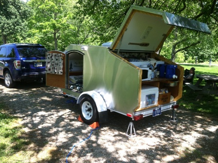

Postby WhitneyK » Mon Mar 24, 2014 8:00 am
:thumbsup: Yep, still holding up after 2 years and 7000 miles :thumbsup:
Are they sturdy enough? My hatch is soooooo heavy (that's another subject I'll be approaching soon). It is 60 lbs to lift from the handle, approx 175-200 lbs where the props are and that's a lot of pressure on the hinge area. :shock:

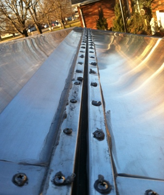

Postby jimun » Tue Apr 01, 2014 6:46 pm
grantstew8 wrote:My plastic hinge is similar to those posted. It's barely used as I'm still building.
If your are in the uk google Albert jaeger they supply truck and bus builders. I'm guessing if it works in that environment it will work on my td hatch. It's called a continuous hinge. Besides being easy to fit its waterproof. :)
Thanks grantstew8, I am in the USA and I did find a supplier here in the states and I already placed my order for 2 - 8'+ (2.5m) plastic continuous hinges. 1 for the hatch and 1 for the doors. Thanks for the youtube video, That helps on how I am going to install it on mine.
For anyone that is interested in these hinges you can get them at Moore Industrial Hardware in Cincinnati, Ohio. You can order on there website http://www.mooreindhardware.com/index.html. I got both hinges for about $90.00 including shipping. They have 2 sizes, 1 is just about 1" (23mm) deep and the other is just about 1 3/8" (34mm). I am trying the smaller one. I did not check the depth when I order, I just thought the design was a little different. If I would have notice the depth I might of went with the deeper one. Image
