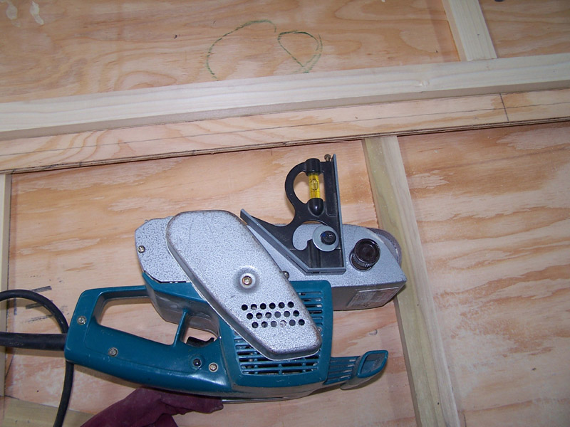

Here is a little something I worked up. I traced out and jig sawed both of my 1/2" plywood sides, then clamped them back to back and belt sanded the edges to make them exactaly the same. However, if the belt sander was not held perfectaly 90 degrees to the wood, one side would be sanded smaller. So I first leveled out my work bench. Shim the legs as required to make it level to the earth. Then I attached a level to the side of my beltsander. This Makita just happened to have an unused tapped hole in the perfect spot for my adjustable T square body. Ensure that the surface you mount it on is 90 degrees to the belt. Now, as I held the belt sander sideways to sand the edges of the ply, I could make sure I remained square. Image

Postby halfdome, Danny » Wed Apr 02, 2008 8:45 am
That's using the ole' noodle :thumbsup: Good idea. :) Danny

Postby Roly Nelson » Wed May 14, 2008 7:13 pm
Great Idea, Mike. See, I'm still learning after 58 years of woodworking.

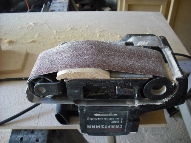

Postby planovet » Mon Jun 01, 2009 2:09 pm
Another use for a belt sander?
ImageMark (& Cindi)
