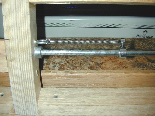

This is one of the return springs I added...

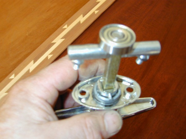

This is what I did to Grant's T-Handle...
Tapped in the ball joints and turned down the square stock to add a roller bearing...
Would buying a premade unit be easier???
Yes, but I'm having fun with this...
Dean in Eureka, CA

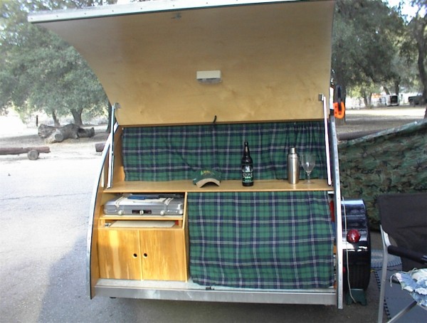

Postby sdtripper2 » Sun Aug 19, 2007 1:34 pm
Heikki:
To throw another Idea out into the mix.
My trailer dosn't use the slam rod type lock and works just fine.
Here is a picture of the rear of my trailer. Note the ONE and ONLY lock
fixture in the center bottom of the trailer.
Close uP look see~ of the lock ~
Front of key lock of my hatch
Back of turn lock mech ~
This trailer has never had an issue with the hatch locking and or moving.
The rods are very secure for one solution but there are other ways of skinning this cat Heikki ~
