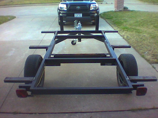

OK, I've extended the sides.
Postby KZ76017 » Thu Mar 17, 2005 10:16 pm
OK, I've extended the sides, got torsion axles, new wheels, different tires. It can be as wide as 6' but I've already cut the floor to 66 1/2". I figured an inch and a half off for two three-quarter inch walls would make it 65" inside.
I'm set now. I can start laying down the floor and put up the sides. I've got to get crackin if I'm going to be able to make the April 9th Teardrop gathering in Eustace, TX.
Here it is

Postby Arne » Sat Mar 19, 2005 6:47 am
On those stubs, do you have support for that corner that seems to be floating in mid-air.? If not that would be a concern for me, regardless of how sturdy you think it is.....
If not, I'd consider welding (or bolting) a piece of angle iron in a triangle fashion from side rail to x-member to support that corner.....
You're going to have about 1,500 pound of force trying to twist that stub out of shape when you hit a big bump......
If I'm misreading your pics, forget I wrote this note......

Postby Nitetimes » Sat Mar 19, 2005 10:29 am
arnereil wrote:On those stubs, do you have support for that corner that seems to be floating in mid-air.? If not that would be a concern for me, regardless of how sturdy you think it is.....
I was wondering about that myself. Just looks a little limp in that area.

Postby KZ76017 » Sat Mar 19, 2005 1:45 pm
Yes guys, I have had a plate welded in that area and I have bolted those other two bolts there. There is one picture there of the new plate welded in place. I just don't have a picture of that finished product with the bolts going through it.
I appreciate your attention to detail though. That's why I keep running these things up the flagpole here in the forum. You guys always point me in the right direction. If I hadn't I'd still have an axle welded to the frame and be building a 4 foot wide teardrop.
