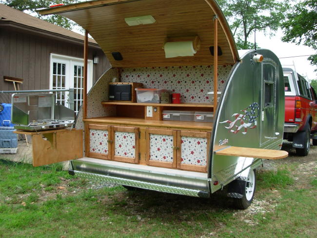

With the 30" that comes with this table support I cut it into three pieces. Now I have a table for each side that is equal to the counter height. If the campsite did not have a table then the third mount was used at a comfortable table height.
Here's a good pic. At this campsite there were so many people I used the table option and you can see the side table at the counter height. Works great.

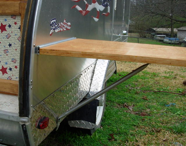

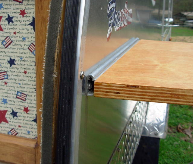

I mounted the rails, as suggested by the mfgr'r, in the same manner as planovet, with the wider piece on the TD, rounded side up. Bought a 30" strip then cut it in half & mounted one piece on each side of the TD using 5 screws in each 15" piece, thru the aluminum siding & the 1/4" luan outer wall with at least a couple of the screws going into the framing of the sides. The smaller rail is mounted on the end of the 3/4" birch plywood table (the 'long' flat on this piece exactly matches the thickness of the plywood). I elected to go with a hinged leg that 'locks' to the bottom of the TD side providing a level surface regardless of terrain, as long as the TD is level. Yeah, I know all that weight is suspended from the side of the TD but, I've used the table to hold a 7gal water jug (approx 58lbs) lotsa times since adding it to the TD in late 2006, with no sign of weakening or distortion of the siding or underlayment at the mounting point. Got plans to build another table to utilize the second strip on the other side of the TD but I'm all out of 3/4" birch ply & don't want to buy another whole sheet just yet.

That's exactly what I did Cliff. I mounted the other piece in the same spot on the opposite side of the TD. I've used the table on both sides a couple of times but the 'swing-out' folding table kinda gets in the way (as in unhandy walking around) when the removable table is used on the 'driver' side. I still plan to build another removable table if/when I ever obtain an extra piece of 3/4" birch ply (if I can remember where I put the spare piece of table rail :R )

This is what mine ended up looking like, with 1/2 a bracket. The bracket may fail some day, but it's screwed into 2x4 lumber, and it will not pull out! I figure it will handle 75 lbs max.

I agree with Mike. My side table came out of another trailer and it was mounted with the narrow piece on the wall with the rounded side up. Of course the larger "hooked" piece mounts on the table edge. It's easy to put up the table in place because the "hooked" piece catches on the wall mounted piece, then the table rotates downward and into place. Works perfect.
Joanne
HA ha
OK, so I been looking at this for a few minutes, as a structural engineer (I can’ help it, it’s what I do!:lol:. OK, here’s the deal. The loads on the brackets are almost exactly the same and you can successfully mount it either way! OK, the loads on the small bracket are just slightly higher (when a moment is applied), so in my case, since the trailer will be made from light-weight materials, it’s probably not a great idea to do unless I buried a piece ‘o’ plywood in the sandwich -- then it would be doable, I’d probably mount the big piece on the tear as it generates, due to the fact it is just a bit wider, slightly lower loads when the table is jacked around a bit and a moment is introduced. Of course, you would never want to leave it unsupported anyway, as that would put a heck of a moment at the root, which would try and pull out the fasteners!
Having said that, if you are careful and if the support leg is installed correctly, there is really not much moment on the piece anyway, and the functional difference between the two methods is small. The wide one does look like you might be able to snag yourself on just a bit easier, but I’m guessing that isn’t an issue either – just make sure and keep the bulb end up!
