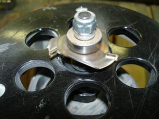

This technique uses a router and if you don't have a router....well, you're going to need one anyway as it's a real versatile tool. Pick up a 3 wing cutter. Shown is an 1/8" one but they are also available in 1/4". It will cut a 1/2" slot into the edge of the ply. The 1/4" one will cut a 9/16 wide slot.
Adjust the cutter so that it is approximately cutting in the middle of the ply. I mark the side that I rout from so if it's not dead on, the sides will mate up fine anyway. Rout all the slots for the matching pieces.

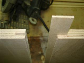

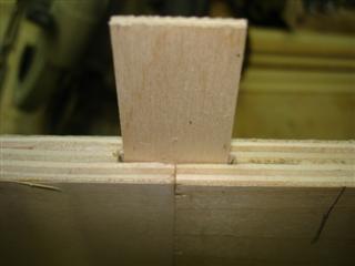

I cut splines out of baltic birch ply. It's a true 1/8" ply so it's a dead on match to fit the slots. I rip them just a hair under 1", if there is any crud in the slot or they are too wide, the ply will want to sort of kink at the joint. A little narrower takes care of any of that. Baltic birch is also stronger than a lot of the cheap plys available when using small pieces.
Glue it all up, make sure to butter the sides of the spline really well and the edges on the ply sides. Weight and clamp, watch too much end pressure with a clamp however. I use epoxy as it gives me more working time, however Titebond works well also.
