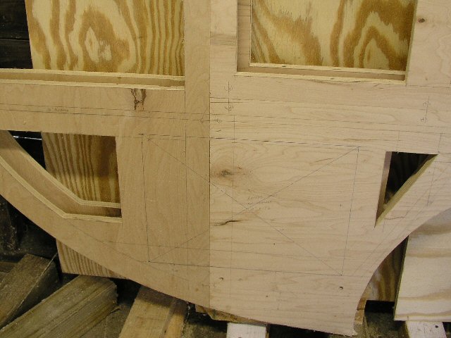

Like MJ, I also used a biscuit joiner. I put lots of biscuits in, and since I had lightening holes in the side, I drove a screw through a clearance hole on one side, into the mating piece to clamp the pieces together. Once it dried, I could take the screws out if I wanted to. If the plywood bulged from the screws, the screws would definitely come out.

using modern adhesives, a scarf joint ratio of 6 to 1 is considered as strong as the material itself. that can be in solid wood or plywood. this means.. if you cut a strip of any width and scarf it together then load it until it fails, it is as likely to break somewhere other than the joint as it is to break at the joint. this also hold true for tongue and groove, a spline or a finger joint. the 6 to 1 ratio does not have to be one continuous surface, it can be many surfaces as in a finger joint. for 3/4" ply, this means 4-1/2" of glue surface. therefore a spline that extends 2 inches into one side is the same as a scarf (give or take). the fact is, you don't need anywhere near the full strength of 3/ 4" ply to make a box because once built it will never be loaded in such a way that it can deflect enough to break. joints glued properly don't just break. you need to load that joint until it deflects enough to stress the joint enough to overload the glue surface, which is quite a bit. if you have a structure that prevent deflection (like a box) you will not be able to break it unless you point load it buy smashing it with a sledge hammer for example.. in the real world, a spline 1/2" deep or a lamello every 6 to 8 inches in tons more than you need.
