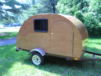

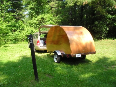

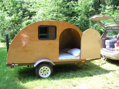

Well, we went camping in the teardrop this weekend! It isn't quite done. In fact, we even brought a tarp to cover it in case of rain because it really needs trim to ensure that it will be completely water-tight. I will also be installing another window (much larger than the one on there), and a roof vent. The interior floor and walls are finished but not the galley. It was awesome to actually get to try it out.

Here are a few photos from the camping trip:
