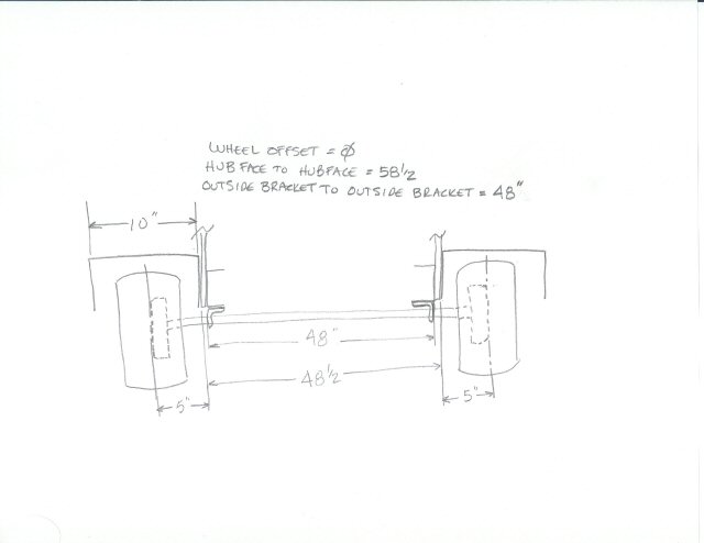

mikeschn wrote:To order the flexride axle as you described... The criteria in this picture should do it...
P.S. If your wheels have an offset you'll have to adjust accordingly.
P.P.S. How wide are the wheels and tires you want to use?
