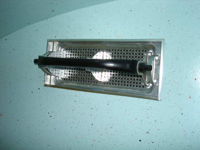

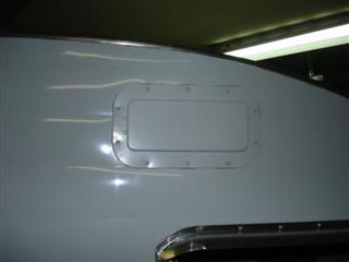

Postby doug hodder » Fri Nov 09, 2012 4:03 pm
On my last trailer, I didn't put in a roof vent either. I went with a step van type side vent. It opens either up or down. Works great. Doug

Re: No roof vent!
Postby doug hodder » Sat Nov 10, 2012 8:01 am
Here's an exterior shot, it either tips out at the top or the bottom. Step van vents are used typically vertical to pull air into the vehicle when moving, like especially on the floor boards just ahead of the door. I just mounted it 90 degrees off so I can open it from the bottom to keep the rain out. Depending on where you camp...small netting may have to be added for bug protection. Doug
Re: No roof vent!
Postby doug hodder » Sat Nov 10, 2012 11:48 am
Probably not....It's pretty old school ventilation. I found it at http://www.millsupply.com It was like 26$ I think. I figured that was worth it to get a new one and not spend a bunch of time trying to track a used one down. A regular wrecking yard with some larger type trucks may have a van with one in it. Doug
