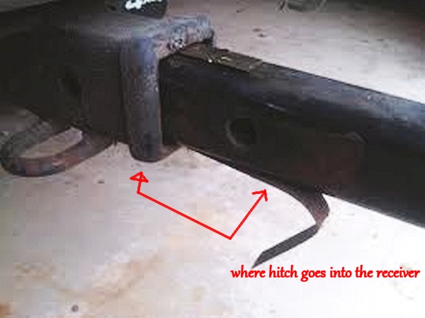

I'm wondering if anyone has any tips about that annoying Hitch Rattle.
I got the hitch installed at U haul, but had to buy the hitchbar from a different company, cuz I needed a 6" rise
The fit is so sloppy. Every start, when the tranny shifts gears, every stop, it's clunking and rattling and thumping, sounds like it's self destructing.
I know there are several anti rattle devices one could buy, but I'm a DIY kinda guy, scabbed this thing together with parts laying around.
Franco Novo wrote:Hi AZ...
I was just looking at a bunch of anti rattle devices online
that one looks the best...I agree....and..I also have a U bolt that fits around perfectly, with a flat plate on the bottom
I'm going to attempt to mod it, just grind a round into a chunk of metal and drill two holes to replace the flat plate ...should be easy
