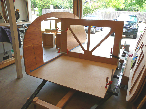

Good question. I wonder how many times I thought about this problem on my first build. Obviously the temporary deadmen are key. They're screwed to the floor and set so a clamp can go through the door openings of the walls.
I always dry fit first, in other words, I assemble without glue just to make sure everything fits. I clamp one wall on first. Once the first wall is set, you can slide the bottom rear bulkhead in and screw from the outside. The same for the bottom slider board. (BTW, these bottom cross members are pre-drilled with kreg screw holes so that once they are glued into the walls, you can easily screw them to the floor for extra strength.)
For the upper slider board, I find a piece of scrap wood that's the same thickness as the slider board and cut it the exact length as the width between the dados, or the distance the two slider boards will be apart. I'll then glue or screw a 1 x 2" (or whatever I have laying around) that overlaps this scrap by about two inches on both ends. I can now clamp this piece to the bottom slider board. I take the second slider board, stick it in its dado and set it on this makeshift support and clamp it in place. (And add a screw to its butt to hold it in the wall.)
I do something similar with the upper rear bulkhead (that sits forward of the lower bulkhead*): One end is placed in the dado, a couple of screws are placed to hold it there, and the far end is held up with a support stick––or leg–– that's cut to the proper height and clamped in place.
It helps to have pencil or chalk marks on the floor to align the crossmembers before you lift wall #2 up.
I build my walls with a 1/4" thick lip that covers the outside of the floor. The internal wall structure sits on the floor. This way, you can set the second wall on the floor, angled out from the crossmembers, and then bring it in while a helper performs any needed alignment of the crossmembers into the dados. And then clamp it to its deadman.
It's actually suspiciously easy. Assuming you've done a dry run.
I use PL Premium glue in these joints and the floor/wall attachment. (I screw from the outside of the wall overlap into the sides of the floor and have kreg holes pre-drilled on the inside of the walls to screw diagonally into the floor.)

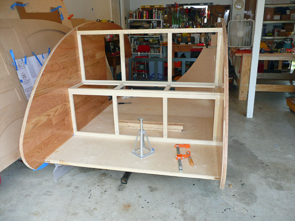

*p.s. My rear bulkheads are staggered. The top one is set 1/2" above the lower one, so that the kitchen counter protrudes into the cabin to form the lower shelf. You can see it in this preliminary sketch of an 8' long Grumman I built:
