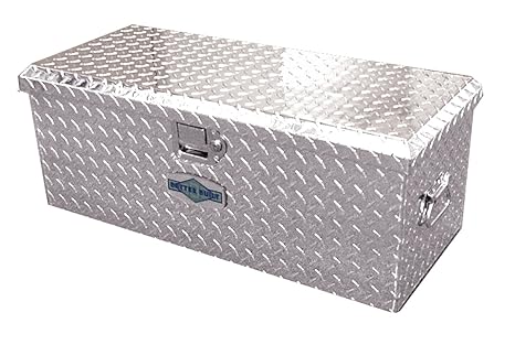

Hello everyone,
I've come to a point in my build where I've decided I would rather have the batteries in a tongue box than inside the trailer. Here's where they are currently, but I'd like to move them out front before I construct the trailer's interior.
The front of the trailer looks like this currently. The tongue is short and I will likely need to fabricate a sturdy frame to hold the tongue box in place.
I've been kicking around the idea of whether I want to purchase a ready made aluminum tongue box (like this 30-inch one from Walmart for $130) or make my own.
I will likely have some aluminum sheeting left over from skinning the trailer, so I could probably build a custom wood frame tongue box and skin it to match. How difficult is it to get a good seal on a home-made tongue box? Can anyone point me to some good threads or photos of tongue box designs? Mine will need to be large enough to hold 3, group 24 deep cycle batteries.
Thanks, all!
Lauren
