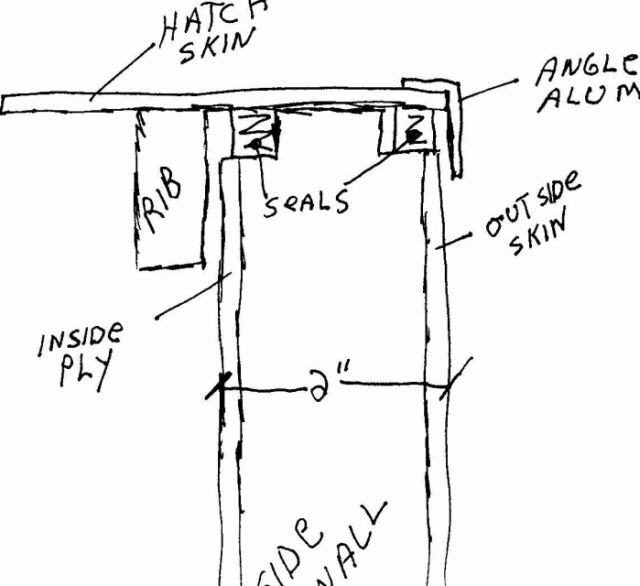

Dean here is a sketch of how I plan to do our seals, I may have to include the gutter in between the two seals. I am just overly concerned about leaks.

Postby Guest » Sat Feb 11, 2006 5:58 pm
Jim,
Are you attaching the seals to the sidewall or the hatch?
I considered attaching them to the sidewall and that would give me an automatic gutter, but I opted to attach them to the hatch, so that they are up and out of the way when the cook is in the kitchen! :twisted: :lol:
