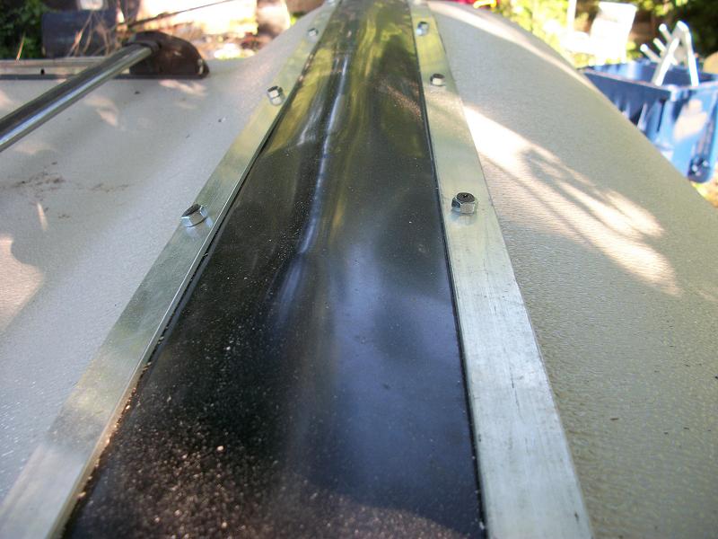

Why ?
Under this is two plain jane butt hinges. No worry about fatigue failures in my life time ! Never a leak and never a problem.
Re: Hurricane hinge type?
Postby GrantRobertson » Sun Jul 29, 2018 6:14 pm
bobhenry wrote:Under this is two plain jane butt hinges. No worry about fatigue failures in my life time ! Never a leak and never a problem.
What type of material is that? Is it plain rubber? EPDM? Vinyl?
Where did you get it?
Did you use a sealant under it? Or does it seal itself, like a gasket, under that strip of aluminum?

I used plastic hinge. https://www.teardroptrailerparts.com/hi ... -trim.html
You need to use aluminum bar stock to attach the hinge. I drilled holes every 4 inches.

I'm with Bob above. I used heavy duty EPDM roofing I got off Ebay. You buy it by the foot and it is 10 foot long. I think it was around $12.00 And a 3" aluminum piano hinge.
