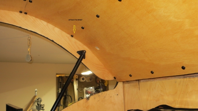

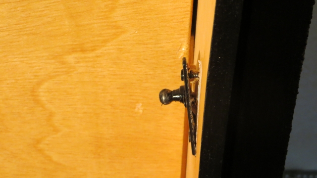

The first is the mounting of the gas springs on the gusset. Since the gusset is only 1/2" plywood it has ripped out. I tried to fix it by putting epoxy behind the bracket then screwing it back down ( I did shift it just a bit so I didn't use the same screw holes) but last night I heard it break loose while the hatch was closed
My first question is, do you think I should move the bracket attachment point from the gusset to the spar in the hatch so it will be stronger?

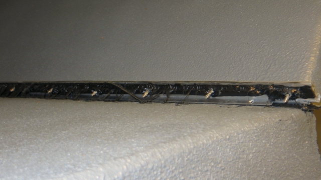

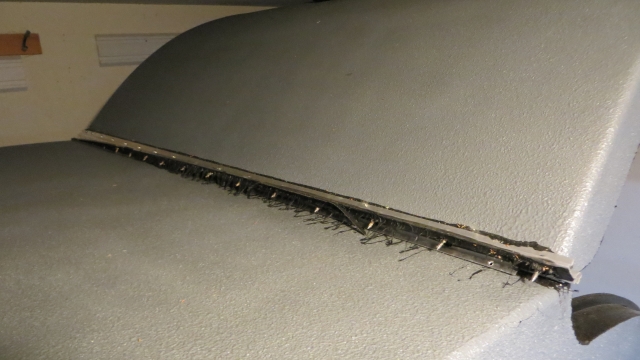

My second problem is that the force of the springs ripped the hurricane hinge off of the roof. I used #8 3/4" stainless steel screws to secure the hurricane hinge. I think I have a geometry/physics problem though.
My other question is do you think the hinge attachment points are located to close to the hinge pivot point?
Causing to much vertical force on the hinge?

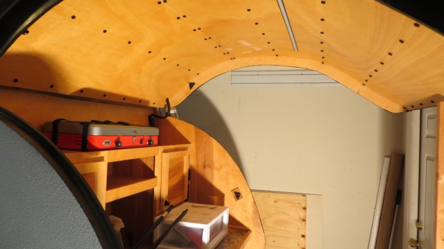

Lastly do you think I need to move the location of the bracket mount on the sidewall? Lower closer to the counter top
You can see here how high the hinge was opening from the locations the brackets are at now.
Any idea, thoughts or suggestions would be greatly appreciated. Thanks

As far as the bracket pulling off ––I think what you need to do is connect it with machine bolts and T-nuts --dump the wood screws. Maybe add another piece of 1/2" ply to the gusset first.

I had a similar problem. I had to make some very heavy duty brackets for the struts. My firs bracket was 1/8 angle and it bent, I made new ones out of 3/16" flat bar. Tony seen them and even asked about them. I'll see if I can find some pictures. and post them.

I think you are on the right track with this. The supports are pretty close to the hinge. moving the supports away from hinge will greatly reduce the force imparted on the hinge. Current config is putting a significant lifting force on hinge. Looks like 80 percent of the hatch weight is prying at your hinge. Every bit you can move the strut support away from the hinge will go a long way towards reducing the load on the hinge. Not an easy exercise, with the elliptical hatch.
