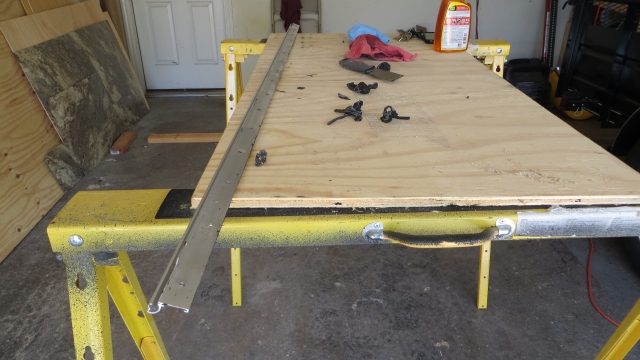

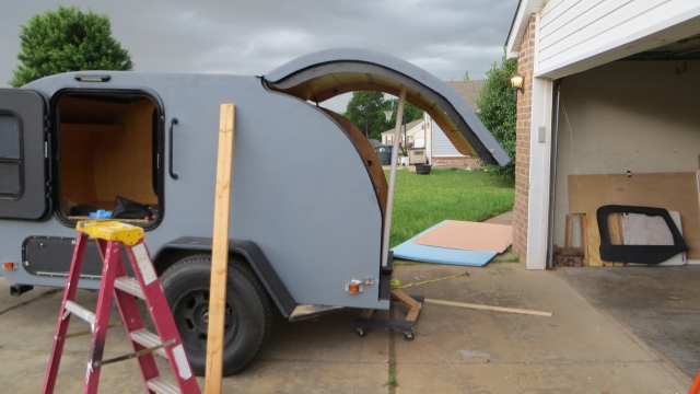

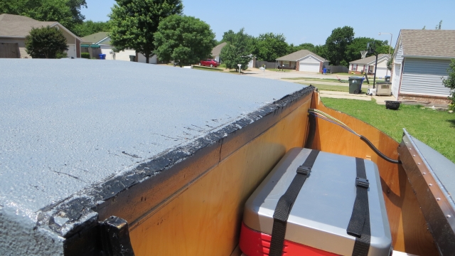

Started back on the hatch today. Got the hinge back on then a storm rolled up on me. This is what I got so far

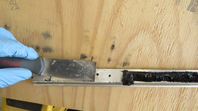

Cleaned the old butyl tape off of the hinge and teardrop. Came right off of the hinge with a putty knife.
Cleaning off the teardrop side

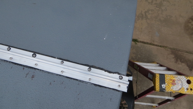

On a side note I had thought about making quick disconnects for all of my electrical connections. In case I ever needed to take the hatch off. I figured meh I probably won't ever need to do that. It was a little windy so I had to strap the hatch up since I couldn't remove it all of the way. Now I wish I would have made the disconnects
I replaced the screws on both sides of the hatch (#10 1 1/2" long) Also added some 3M 4200 to the screws before I replaced the screws

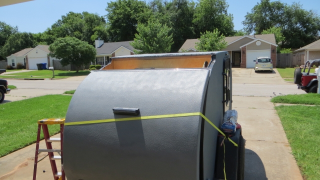

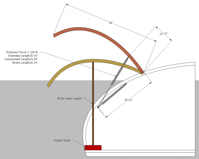

This is when the storm came in. I managed to get this weighed real quick. My dead weight at this position came in at 80 lbs which previously I had it at 100 lbs
That is where I had to stop

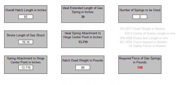

I did input the new dead weight into the spreadsheet and then looked for some gas springs close the new force.
I found this one on McMaster https://www.mcmaster.com/4138t63
Extension Force = 100 lb
Extended Length 35.43"
Compressed Length 19.29"
Stroke Length 16.14"
Compression Force 136 lbs.

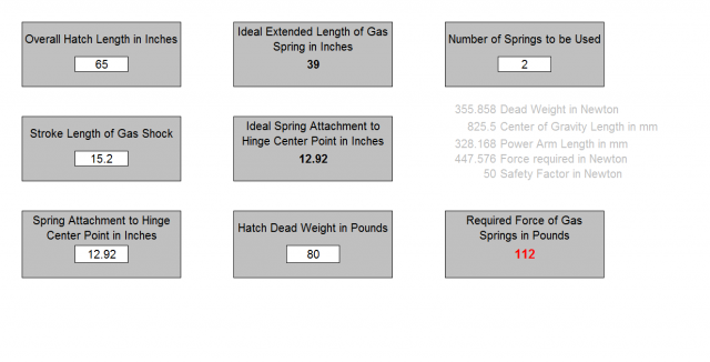

Then I found this one at Lift Supports https://www.liftsupportsdepot.com/lift- ... t-support/
Extended Length: 36.00
Stroke C [in]: 15.20 (Changed the stroke length in the spreadsheet see below)
Compressed Length B [in]: 20.00
Force (Lbs): 120

wonder if 100 lbs would work okay?
Tom I was thinking it might as well
(I suspect so, but realize, if it doesn't, it means re-positioning your struct mounts.)
I was wondering since I could only find 36" gas springs instead of the recommended 39" how that changes the mounts?
The Ideal gas spring length isn't 60% of the hatch length at 36"
Which that should change the ideal attachment point 85% of spring stroke as well

The attachment points and required force are based on the length of the struts you purchase. The overall hatch length and ideal gas strut length are not used in the calculation for the required force. They are only used to determine the ideal strut length. The attachment points are calculated based on the overall length and stroke of the struts you purchase. The lower attachment point should be equal in length from your hatch hinge point to the overall length of your struts. The upper attachment point should be 85% of the stroke length from the hatch hinge point. The strut force required is calculated based on the dead weight of your hatch and the calculated attachment points of the struts that you purchase.
The 100 lb struts should work. Instead of having a 10% safety factor you will be closer to a 5% safety factor.
Based on the information that you provided on the 100 lb struts your attachment points should be as follows:
Lower attachment points on the galley walls: 35.43" from the hatch hinge point
Upper attachment points on the hatch: 13.72" from the hatch hinge point
These attachment points should allow for the proper lifting force and the struts to be compressed 85% when the hatch is fully closed.
The only other thing I would check is to get a longer prop stick and try to measure the dead weight of the hatch from the ground level. In your picture it looks like your prop stick is at an angle while you are measuring the dead weight. I am not sure how that would affect the true dead weight, but it would be easy to verify. The prop stick should be plumb to give the most accurate measurement.
