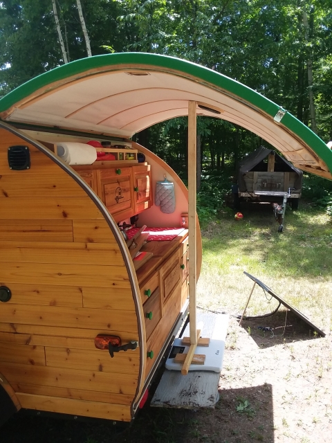

I don't understand the part of the calculation that determines weight.

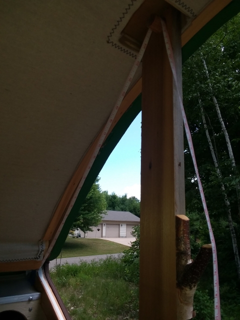

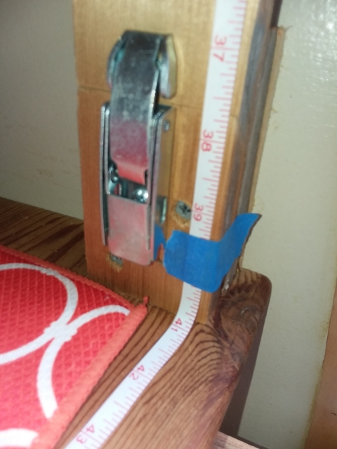

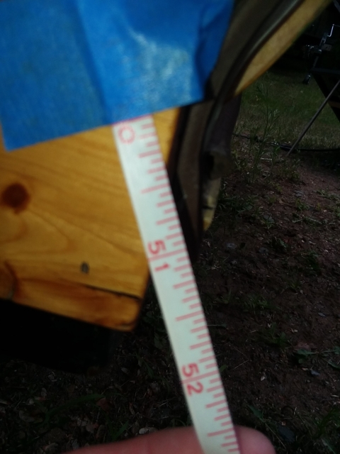

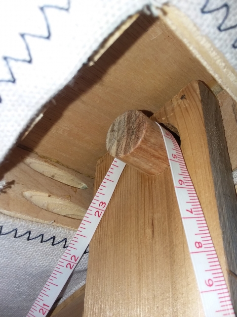

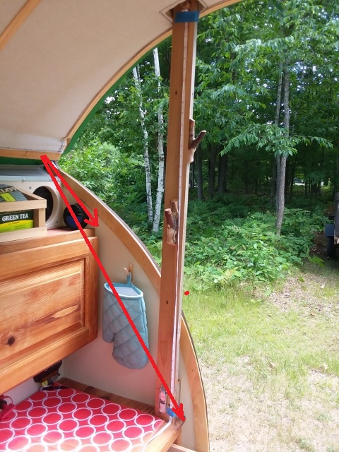

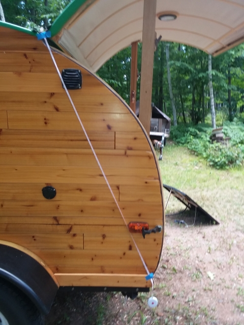

danlott wrote: What is the distance from your hinge to the top outer corner of your top cabinet? What is the distance from your hinge to the top outer corner of your lower cabinet/counter top?
Dan
jiyuu4life wrote:First of all thanks to all in this forum (TNTT). It has been a great help in my build. I am currently ready to install gas struts. The calculator has been a great help and matches other calculations that I have found. My question is the calculator says "Required Force of Gas Springs in Pounds" 95 lbs. The actual door weight is 60 lbs. What is not clear is do I need two springs at 95 lbs each or 2 springs at 95/2=50 +-? Thanks Todd
