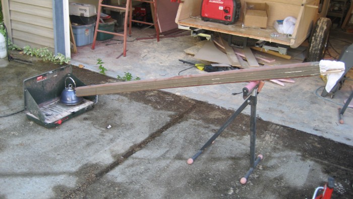

You can't steam bend wood without a fancy teapot, a Coleman stove, a piece of discarded downspout and a rag to stuff in the end.

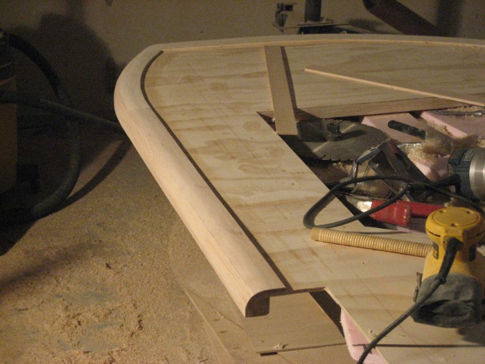

And you can either laminate strips for a solid edge (1/4 ash shown) or you can scarf a piece of wood and bend that too (also shown)...

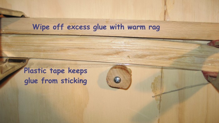

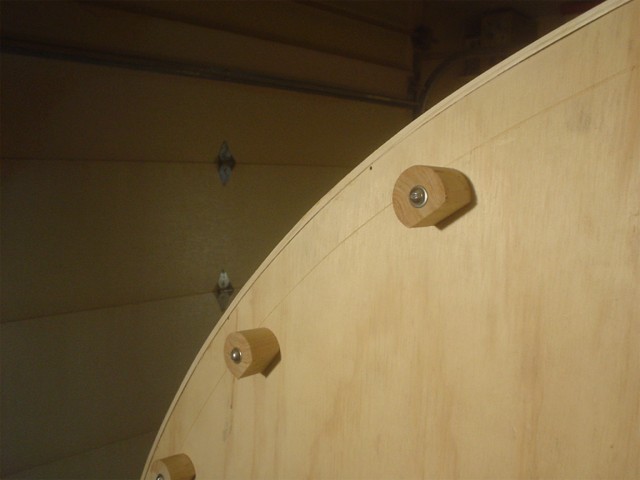

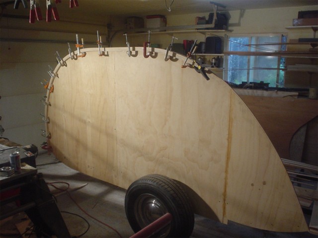

Hope this helps....The laminated piece and the scarfed piece had different purposes. The laminated solid wood was rounded over as part of the finished design, and the scarfed piece is only to create a track to slide the headliner in...so it didn't mater if it were scarfed as it would not show. To get the shape, I started by screwing some pieces of dowel with a flat side for clamping along the bend line.
Then using clamps, bent the steamed wood into shape...
This is on the side, but the thought is the same...use some plastic tape when glueing things up to keep them from sticking.
Here is finished rounded over edge from the solid laminated piece.
