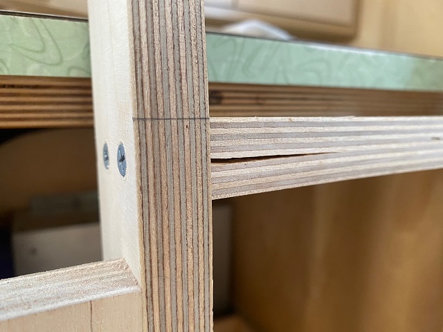

tony.latham wrote:My only concern would be splitting from mechanical fasteners
Yup. Even with pre-drilled pilot holes!

Postby gudmund » Sun Apr 11, 2021 11:09 am
if there is a problem to be had with using plywood spars, it will end up being with the 'one' where your hurricane hinge mounts/connects to, if it is installed with the hinge mounting screws being screwed thought the wood plys as mine was = it will end up splitting the spar even is pre-drilled (as seen in the picture shown here). My first trailer, the builder installed it this way and after a year or two of use the whole setup started 'rocking back and forth' every time I opened the door, which told me something was wrong :roll: I was able to do a 'half-..... fix' by pre-drilling from the quarter side of the spar in the gallery and running a screw in between each one of hinge screws, thus squeezing's and holding the 'split' spar back together (just 'another' example of '1' of the reason's why I got rid this trailer a few years ago). Once something like this happens in that area of a teardrop... there really isn't much of an "easy" fix for it = kind of hard to 'undo' what was done when built, without a total rebuild of this door hinge area :frightened: :cry:

One way to try and minimize the risk of this is to stagger the screws a bit so each one is biting into different plys.
