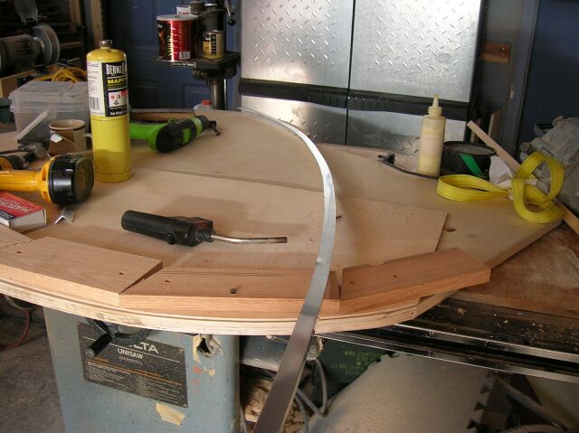

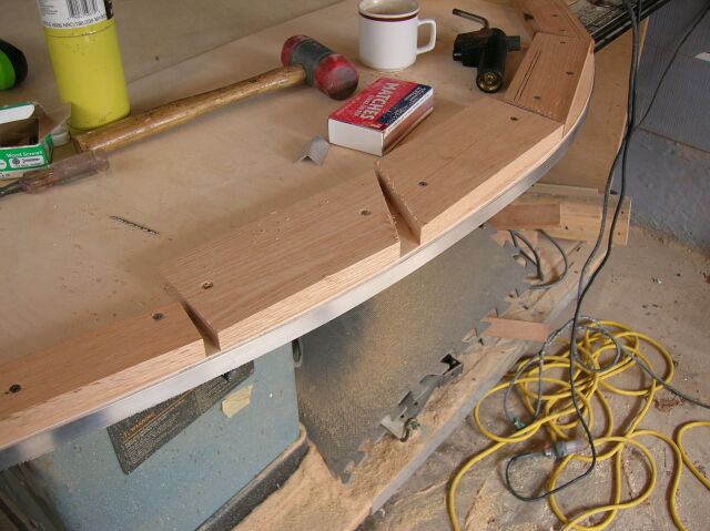

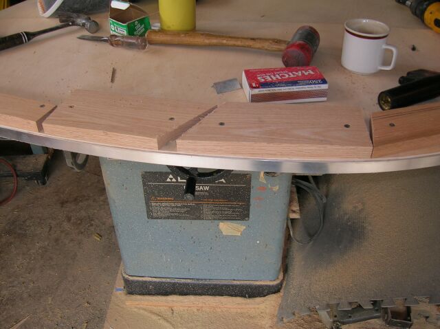

Cary, I really appreciate the information. Things went a lot smoother today and I am pleased with the results. There was one small ripple in the whole bend but it will be easily fixed. The jig we built made it very easy to bend and no ripples. Here are a couple pictures of the jig we made for the 3/4 X 3/4 X 5 foot piece.
This is with the angle in the jig after it was bent.
These two pictures are of the trim after being bent.
Jack, thanks to your help the annealing went soooo easy today and it bent like butter. Thanks my friend.[/img]

Postby madjack » Sat Mar 11, 2006 7:53 pm
Jim, good t hear it went better today...and as Cary said, this is one of those things with a decent learnig curve to it...to that note I had bought a couple of pieces of 3/4 cahnnel and a few months ago and basically destroyed, as I tried different annealing/bending techniques...it paid off in the end
Cary. it was closer to 40 bucks which incldes the 2 frames to make up the jamb and the piece to wrap the door...SS hinge excluded...we are right at 10'6" also...we used 8 ft pieces to go hinge to hinge and a 30(?)" hinge with a cut down piece behind it...oh yeah, that tap and pull technique is what I was trying to descibe to Jim...works so well
Postby Cary Winch » Sun Mar 12, 2006 2:56 pm
Jim,
Heh, that is one fine piece of bending. That is one of the harder bends to make with that long a leg.
