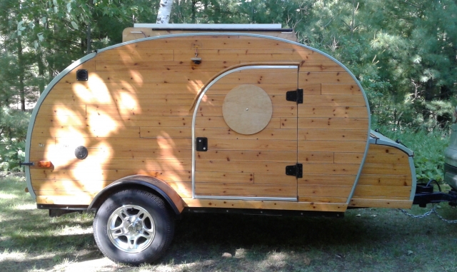

Re: DIY Round Windows (old ship building technique)
Postby TimC » Tue Jan 30, 2024 4:52 pm

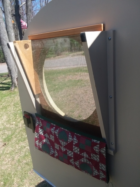

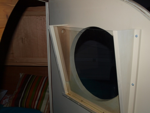

Yep...
And I made a watertight plug to fit for traveling in the rain.
Very simple design and build. Found here on tnttt!
I'm sure you could build them without a plug if you account for driving in the rain. I didn't think of it until I hit a downpour on a trip and found the weep holes and lip I designed did not match the intense rain volume.
Weep holes... 3/8" filled with epoxy then drilled out with 1/4" to allow drainage. Work well when standing still. Not so much when driving in a downpour.
Tim
Niagara, WI
TimC
Posts: 1372
Images: 733
Location: WI/MI border

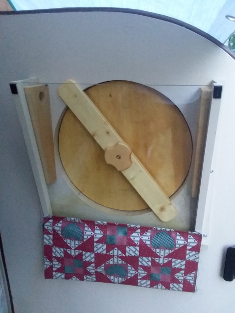

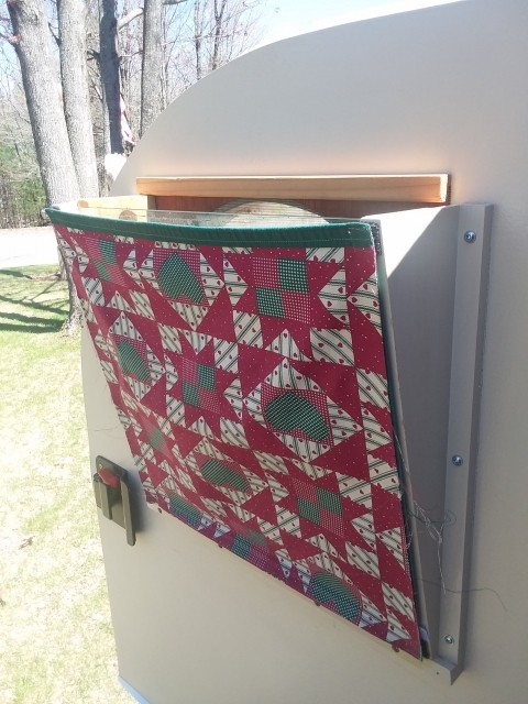

Postby TimC » Tue Jan 30, 2024 8:45 pm
Hi RBB. My Wiley windows are not the first and not the best I've seen but I'm pretty proud of them.
Yes, the screen frame and glass do work with the wedge in three positions. Fully closed, screen closed with window open and fully open. If I were to build it again I would plan for a larger "trough" and bigger weep holes; though I think I would still use plugs to waterproof it completely.
My screens are slapped together and could use better materials. The frame is just untreated lauan. The screen is fiberglass fly screen hot melt glued to the lauan. They have held up since 2016 so I don't have much incentive to redo them. Never had problems with no-see-ums so far.
I would redo my curtains as well. Right now they don't cover the top of the opening and "sometimes" I like to sleep past sunrise.
And yes, the doors have to be open to remove the glass. I've only had the windows wedged open at night. I've never been anywhere that I needed the glass removed. The ventilation, two 35cfm case fans, move enough air to stay comfortable.
