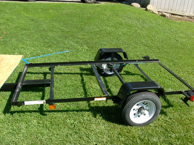

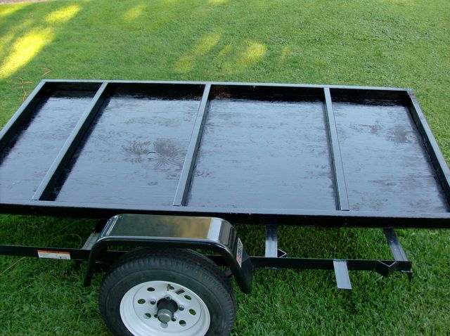

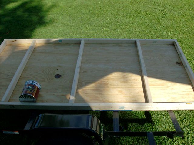

Well I have started building my teardrop. I am basing my profile on Joanne's Desert Dawg but 4x8 in size. It seemed like a nice and easy build, no curves to worry about. Since I know everyone likes pictures, here they are.
Day 1

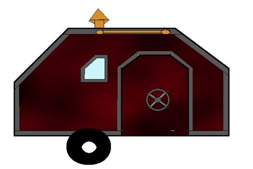

Design plan
Trailer

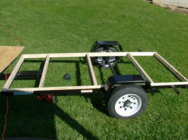

Sub frame
Floor on frame
Bottom
Asphalt post paint
Bottom painted
That is it for today. Tomorrow hopefully the walls.

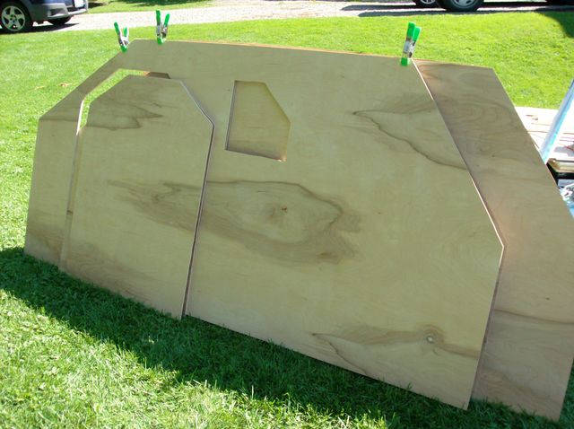

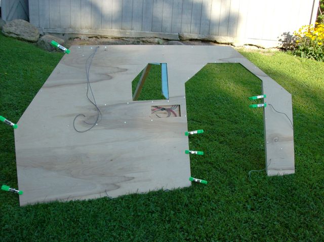

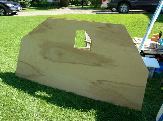

Profiles cut out of luan, I did all four at one along with the windows.
Door cut out of the driver side.

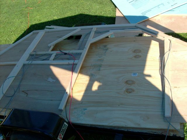

Frame built out of 1x2 and 12 volt wires ran.
Inside wall glued into place and switch panel cut out. I forgot to take a picture of the insulation, but that is boring.
The style I am going for is a steampunk/Victorian SciFi style. The two vent pipes are going to have fans installed to help cycle the air and have a cone cover to keep out the rain. This should make it look like furnace pipes. I plan on having a battery installed to keep it isolated from my car for the 12volts along with an inverter for any minor power I might need. I don't plan on doing extended trip, just weekends.
Well that is all for today, most likely I will have no more time to build until next Sunday.
