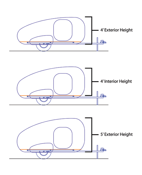

My tear will be 5' wide, so I am thinking I could go to 5' high also (having to buy 5' wide aluminum for the top, might as well get it for the sides also). I want this to be relatively light though and I really like the sleeker looking designs, so my question is "does interior height really matter?" Obviously we will not be able to stand regardless of what we do, and my wife and I are not tall people (5'8" and 5'6") so is the interior height really that important? I want the interior walls to be wood, so thinking 4' high max. for the interior may be best to avoid a seam and since I want the exterior aluminum to cover the frame I would need the 5' aluminum on the sides, unless I make the exterior height 4', but that only gives us about 40"-42" of headroom. Is that enough? Also, does a seam on the wood skin (underneath the aluminum) decrease the strength? If I go to 5' tall do I need 5' wood or can I put a seam with compromising the strength? Please look at the attached photo and let me know your thoughts (this is my first time posting a picture, so I hope this works). Sorry for the rambling.

Postby mikeschn » Sat Feb 10, 2007 4:16 pm
RichAFix,
What is your tow vehicle?

Postby Jst83 » Sat Feb 10, 2007 4:34 pm
I sat down and put a little mark on the wall then added a couple inches to get my inside height. My ceiling is only 45" inside and I'm 6' and don't feel at all cramped. So I think 4' would be more than enough inside or outside.
Added thought I guess what is most inportant is the profile you like 4' or 5' height it's what you like that matters .

Postby mikeschn » Sat Feb 10, 2007 4:51 pm
I guess the better question is, what do you plan on towing it with most of the time. If it's the PT cruiser, build it 4' high on the outside.
If you buy a mini-van, you can build it 5' high on the outside.
A 4' high teardrop is comfortable enough to sleep in, and sit up in if you're average height.
If you want a table you'll have to increase the height significantly, and/or add a dropped floor.
If you want to stand up in it, then you'll want to consider something like a Winter Warrior.

Postby Jst83 » Sat Feb 10, 2007 5:09 pm
How did you come up with 42" for the inside height? I couldn't tell from your pics.

Postby RichAFix » Sat Feb 10, 2007 5:22 pm
I am just figuring with the height of the trailer frame (as I want the aluminum sides to cover the trailer frame), the thickness of the floor and the thickness of the ceiling I would loss about 6 or so inches. Do I have to worry about strength issues if I go taller than 4' because a seam in the plywood? I also want this as light as possible, even with a capable tow vehicle, I don't want to lug around too much weight and I really want refrigerator/stove/sink so I am already worried about weight. If a few inches in height doesn't cause strength (due to the seam when I go taller than 48") and weight issues, it seems like a pretty simple solution to just go a bit taller, but I really like the shortest look if it isn't going to be too claustropobic.

Postby Leon » Sat Feb 10, 2007 5:33 pm
On mine I cover the frame (2"), 3/4" floor, and 1 1/2" ceiling, so I end up with about 43 1/2 to 43 3/4" which is plenty of room for us. I'm 6' and Sharon and I sit inside when it's raining without any trouble. The extra that you gain may not be worth the extra drag and weight.

Postby toypusher » Sat Feb 10, 2007 5:34 pm
RichAFix wrote:I am just figuring with the height of the trailer frame (as I want the aluminum sides to cover the trailer frame), the thickness of the floor and the thickness of the ceiling I would loss about 6 or so inches. Do I have to worry about strength issues if I go taller than 4' because a seam in the plywood? I also want this as light as possible, even with a capable tow vehicle, I don't want to lug around too much weight and I really want refrigerator/stove/sink so I am already worried about weight. If a few inches in height doesn't cause strength (due to the seam when I go taller than 48") and weight issues, it seems like a pretty simple solution to just go a bit taller, but I really like the shortest look if it isn't going to be too claustropobic.
2 things:
1. If you want the AL to cover the frame, then you don't have to have the sides cover it. Set the sidewalls on top of the fram and let AL run down over the outside.
2. If that does not work. Just build the walls of sandwich construction with 3/4" framing and ridgid insulation, 1/4" outside plywood and 1/8" inside skin. As long as all of this is adhered properly, your wall should be plenty strong. Remember that your bulkheads and roof spars will add alot the to strength. When done, it will be one solid box.
See Steve Frederick's website or the Lil'Diner construction threads for more on how to do this.

Postby madjack » Sat Feb 10, 2007 5:34 pm
Rich, I am 6'2 and worried about that as well and considered the 5' height but stuck with the 4'...if it where 5' tall, I don't know what I would do with extra height beside heat and cool it...our sides come down over the 2" frame and the ceiling is 1.5"s with a 5' foam mattress and a 1/2" floor which leaves you 39"s and there is wayyyy adequate headroom....build 4', save the money and bye yourself a purdy geegaw :D ...my .02cts...
Postby mikeschn » Sat Feb 10, 2007 6:07 pm
Rich,
Since you are a CAD designer, grab a mannequin and pop it into your design.
Andrew is the man with the mannequins. Send him an email...
