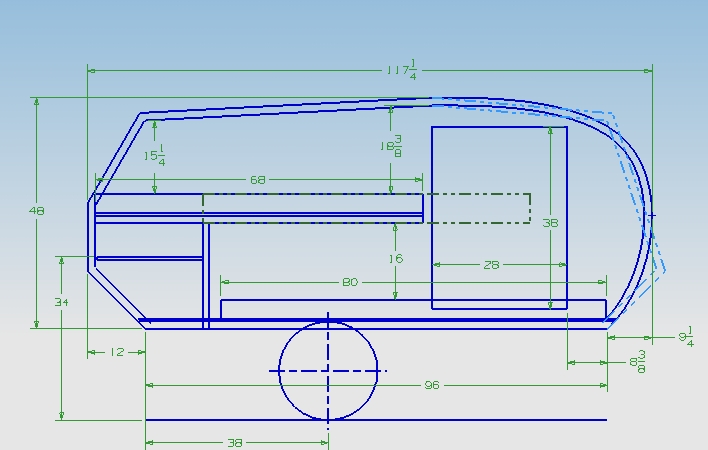

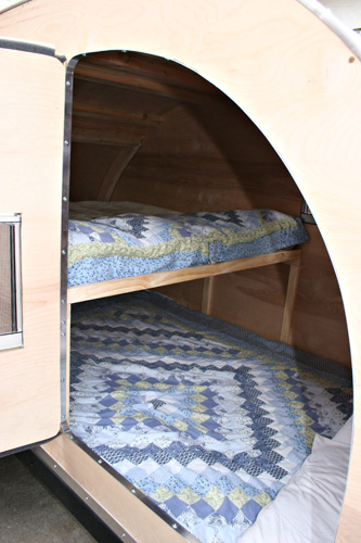

Alfred,
I tweaked the design just a touch this evening. Here's what I have so far..
It's built on a 5x8 chassis.
It uses weekender style construction.
The kids bed slides forward during the day so you can use the galley, and slides back at night so that you have room to sleep.
The adults have 18" of airspace for their legs, and the kids have 18" to sleep in also.
The adults have a queen sized bed (60x80)
The kids have a shortened queen (60x68)
and if it looks like the body is way up in the air... it is... just like the Escape Hatch...

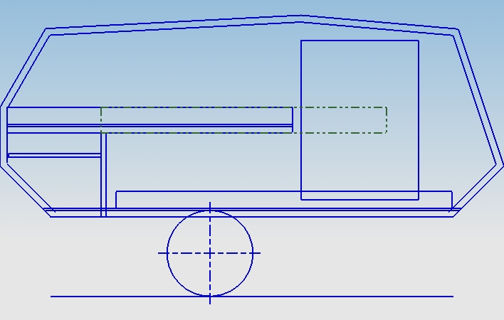

Wow! Mike that looks great!...And more questions...
Postby Alfred » Mon Nov 05, 2007 7:03 pm
Wow Mike,
Your drawing looks great! I know the weekender is a simple build, too. Do you think it would be much more difficult to do a rounded weekender? I really like the looks of the rounded version, but it looks like the sqared off verision would be easier!
I've been looking at the other build on the list, that is similar, but with a stationary bed (See picture below). The slide would certainly give the kids more room to grow. Do you think it would be much more difficult to add the slide than to make the bed stationary? Would there be much loss of structural integrity without the stationary bulkhead there?
(Edit: I just realized that's a dumb question. The bulkhead is still there, right? The slide-out goes over it?
Wow! I really appreciate you working on this. I can picture it a lot better now!
Al in Asheville :thumbsup:

Postby mikeschn » Mon Nov 05, 2007 7:26 pm
The slide is real easy to build. You screw a 2x2 to the inside of each wall, and set the bed frame on that. To slide it, you just pull.
A rounded weekender is only slightly more difficult to build. If you have access to 1/8" plywood that I would definitely consider it as an option.
The hatch is more difficult to build if you have a rounded one. Perhaps you want a rounded front and a flat rear for the flat hatch.
Your bulkhead would go halfway up, so you'll have all the structural support you need.

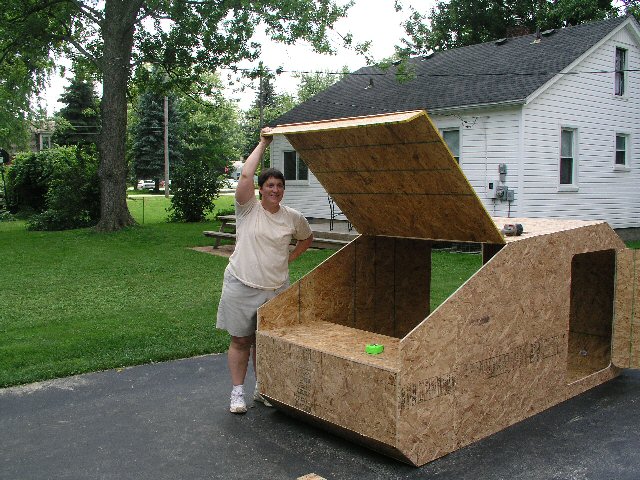

Look how easy this hatch is to build...

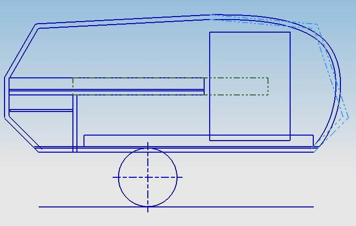

This design IS 10' long. It does extend a foot in front of and a foot behind the trailer, only it does so at an angle...
BTW, I rounded off the front for you.
Now go sell 20 pieces of silver and go buy that trailer! :lol:

Postby mikeschn » Mon Nov 05, 2007 8:26 pm
I added a few dimension for you to assist in your planning. In doing so I realized you only had 14" of airspace for your legs. So I moved the upper bed up a couple inches.
It's tight, no matter how you look at it. If you can get a lower trailer you could add a few very valuable, very needed inches.

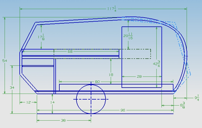

Postby mikeschn » Mon Nov 05, 2007 8:40 pm
If the top of the bed is really 14" off the ground, that's 5" less than a HF trailer. You could add that 5 or 6" to the side of your trailer, and give everyone a little more room.
As for the front lip, that can disappear into the floor.
Here's the design with the new dimensions...
Alfred wrote:The wheels are 12". The bed of the trailer sits about 14" off the ground. The axle is 5' from the front and 3' from the rear. It takes a 1 7/8 inch ball hitch. There is a 2" ledge/lip that runs around the front and sides of the bed (but not the rear).
