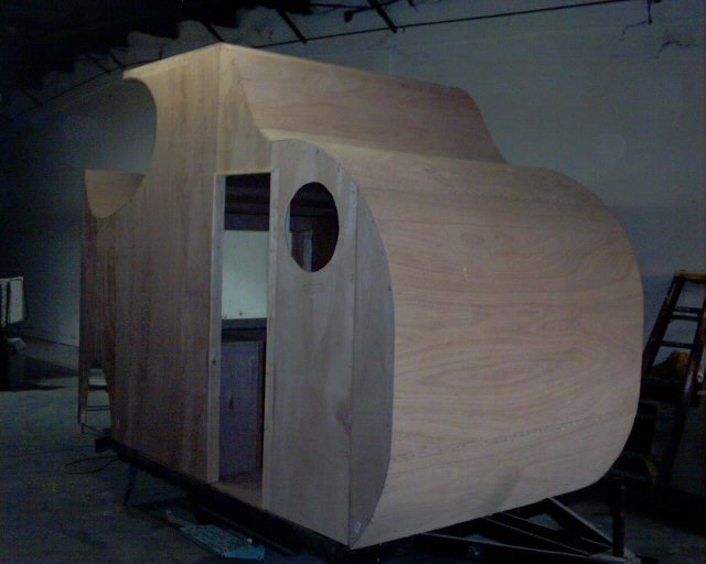

by the way, these pictures arent current, i had to temp. stop construction (so as to avoid making mistakes) i needed some time to plan and make decisions, (or i would have been tearing out and redoing)
the total body height is 8' and i know thats tall, but yes there is a sleeping berth up there, the top / roof will raise another 22" and will have window screening, there is a ladder to access this area,
there is a window with a closeable shutter on the rear wall of this berth,
the galley is of course in the rear, yet to be designed, there is a door thats the same size as the rear that lifts up to create a roof over galley, there will be 2 other doors that hinge out to create sides on galley,
shower curtain across rear when all are opened up,
there will be a 24" wide door added on other side to match existing,
there will be hinged porch floors & roofs that look like fins on both sides,
water storage in top rear recessed area (exposed) that will feed the sink and shower that will be on fold down porch, portapotty there also, both will be surrounded by shower curtain and accesible from inside or out,
2 benches with a table that will make a bed on the inside (rear)
pass thru window (24" wide) from interior (table) to galley,
two bunks in the front, bottom 24" wide, top 36" wide,
storage area recessed in nose,
