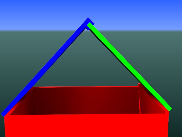

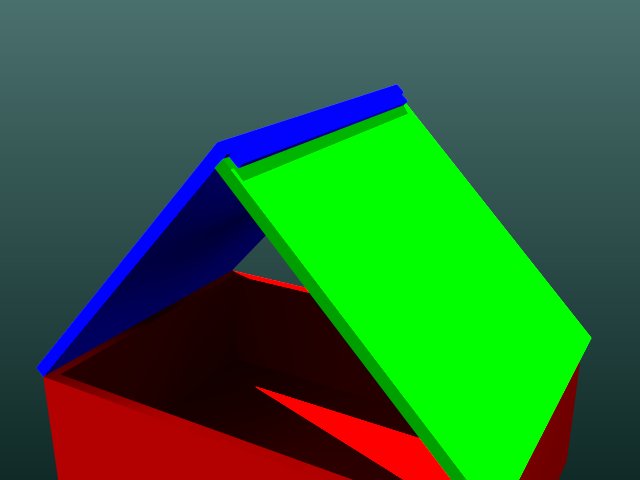

Postby jml79 » Mon Sep 22, 2008 11:24 pm
Here are some quick drawings.
When I was drawing it I realized that one end would have to be offset by the panel thickness in order to allow the whole thing to close flat. I then decided to make the grooves not quite full width and then put the groove panel on the bottom when closed. This allowed for a smaller offset over all but you would have to swing the green panel up a little higher during setup and then swing the blue panel out from under and then on top. I thought it was a small price to pay to reduce the offset. Just my opinion. Let me know what you think.

Postby bgordon » Tue Sep 23, 2008 2:43 am
Hi,
Interesting thread!
By the way, you won't even need the groove if your gas springs are correctly installed and at the the right strength (pressure). The roof will stay upright.

Postby jml79 » Wed Sep 24, 2008 11:38 am
I agree that you could do that as well, I prefer tying the structure together mainly because I live in Canada and have had snow on my roof and camped in very strong winds and would just like the security of knowing that there is that little bit of extra strength. However, I wouldn't likely use gas struts as I hate them. JMHO.

Postby Fuzzy Bear » Wed Sep 24, 2008 12:13 pm
I agree that the 2 roof halves should be tied together somehow, not quite sure of the mechanics I will use yet. My biggest concern is high winds. I'm thinking of allowing the 2 halves to work independently while being raised, then some type of interlocking setup when fully raised.
