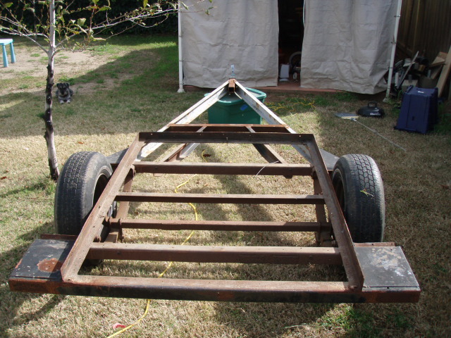

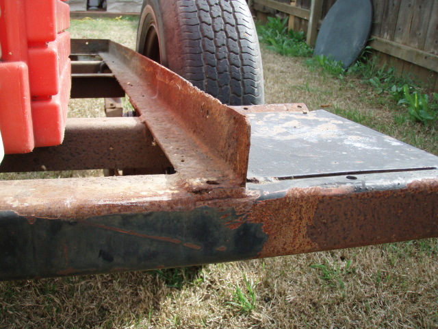

:lol: So the trailer is not complete
I think its going to work out fine- though the light weight goal may be out- the tongue extension is 4”x1.75” and HEAVY-
Groovy drop axles- about 33” from the rear
15” rims- 6 lugs?!?- u-haul
The rails- or ‘styles’ are 2+” tall but also where the springs are mounted so I’m leary about grinding them to flat- at least not in those areas.
50.5” between the side rails so a 48” wide might be funky- I may have an easier time going 5’ wide and building over the tires- :twisted: again wood does what I tell it to metal- well…

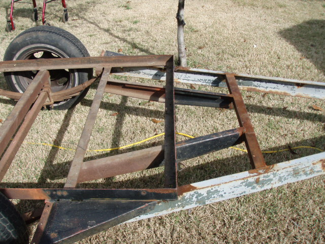

Postby stomperxj » Sat Feb 21, 2009 3:09 pm
I agree with Miriam. Looks like someone added that huge tongue later. Here's a crude MSpaint version of what i would do:
cut the big tongue off, put a 1/4" or 3/16" plate to connect the two original tongue angle pieces and run a new single 2x2 tube from below the front crossmember through the plate. That would be an easy way to fix that and shouldn't cost that much for a shop to do. That white added tongue is ridiculously long.... :)
*edit* You dont want to cut any off of the side angles. those are your main frame rails and give you all your strength... the rest is heavy duty and should be fine. I'd make it as wide as the trailer is.

Postby RogHodge » Sat Feb 21, 2009 3:27 pm
The forward most cross member is only 7' from the rear- the ball is 5.5’ from a point 8’ from the rear. :?
The “box” is roughly 4x6 so this thing is quite small if I’m going to sleep in it I need to build over the tongue.

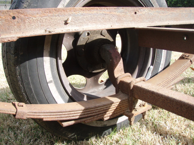

Postby Steve_Cox » Sat Feb 21, 2009 4:01 pm
Sure has lots of leaf springs 8) 3 or 4 too many

Postby angib » Mon Feb 23, 2009 10:19 am
I would:
- chop out that original inner A-frame;
- cut the long A-frame off the side rails;
- cut off the ends of the A-frame outside the side rails;
- slide the A-frame back and weld it to the side rails and front cross-member.
Something like this:
(only without all the parallax issues!)
Andrew

Leaf springs- Yes there are a lot but no real need to eliminate any- right?

Postby Miriam C. » Wed Feb 25, 2009 1:05 am
:o :D Dean I got the wise advise to remove and clean the springs before the wood was on. So much easier. Now if you build heavy you might need some real stocky springs. 8)
Yes you can leave the corners to support themselves. 2x? and 1/2 ply should keep you from falling off. You can add wood to make the frame above the angle. You might even be able to use the existing iron to help that.

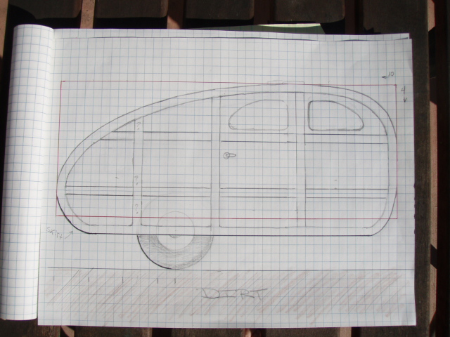

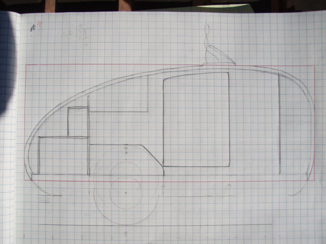

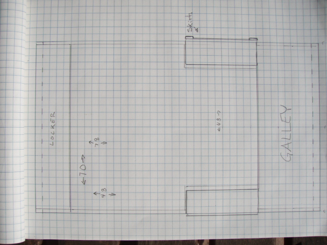

Postby RogHodge » Sat Feb 28, 2009 12:25 pm
The design continues- As you can see I took a little time to think about this- the profile is slightly more “squat” than a real Cabin Car. I wanted a skirt to hide the Ugly frame.
Several design elements need work (windows for example)
BTW- each square = 3” and the red line = 4x10’
I’m somewhat clueless about galley and floor plan details- would love some feedback on all of this.
Not sure about tire clearance? What should I allow for? 6 inch of travel seems like plenty- the trailer only has about 1” tire to frame is that sufficient?
I covet your feedback (the good kind)
