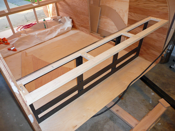

Postby aggie79 » Tue Oct 20, 2009 8:59 am
We are building ours in the conventional manner. To provide for sitting headroom clearance, we have a front headboard cabinet. The face frame of the cabinet is angled to provide a comfortable seating position. You can see the layout in the dado on the sidewall.
