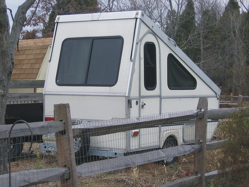

Aliner made a model called the Alite, I have only ever been able to find pictures of one:
I modifed my design to be similar, but did not like it:
    - Reduced headroom
    - End lift wall is very tall
    - End lift wall leans in
    - Side lift walls are taller, and have to overlap when closed (with my design they do not)
The main advantage to their design is the lighter roof. And without insulated sidewalls as part of the roof, the body can be a bit wider, too.

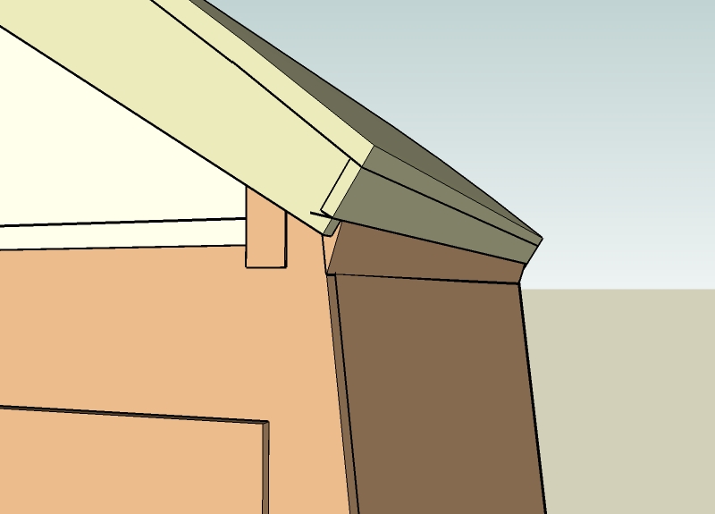

Postby starleen2 » Fri Jan 01, 2010 7:27 pm
The only problem with the auto style hood springs are the side walls. A folding wall WILL get in the way of the springs. If they are mounted at the rear on the inside, then you can’t fold up (or down a wall) And kind of lifting mechanism will have to be external when you folding up two full walls. Look closely at the A-liner above – it’s rear hinge pivot is on the outside. That’s where your spring would have to be mounted. Sorry - you can’t hide the springs in cabinetry – how would you fold up the side wall with out notching out for cabinets?

Postby Ageless » Fri Jan 01, 2010 7:31 pm
If you mounted the spring hinges slightly inboard; that thin wedge section would clear when folded

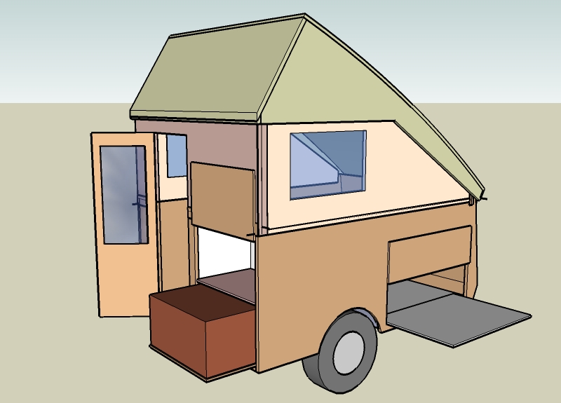

Mike, good thoughts...
Not sure which version you were referring to, probably the second one with the high part to front? Door on the side?
Here's a look with a scootched over rear door and a rear slideout galley, and outside under-bed storage access. There is galley space also above the slideout part, with a lift up lid:
I like the idea of it being easy to cover with an awning. I see the pullout having a wall mount faucet recessed into the right side, with a panel that drops dow to support the tub... 8)
Note also the roof now has a curve to it, providing drainage when closed and a touch more headroom when open. (And a bit more style...)
The hinge I have in mind could just be a piano type, but a hurricane hinge may be better. The hinge point is outside, but there is a zero possiblity of water getting inside since it is below the level of the inside wall. It attaches to the rear of the roof, and a block secured to the body, right there at the junction of beige and green:

Postby jagular7 » Mon Jan 04, 2010 11:31 am
navigator wrote:.....snip.....
.....snip.....
The roof looks really pleasing now. However, if you wanted to keep it flat, look at a full size long bed pickup bed tonneau cover. Unless the width of the camper is wider than the top.....You can pick these up rather cheap on your local CL.
The hinge idea is something I thought about myself but haven't looked too deeply into it. Same for the tonneau cover.
Since my camping may involve 3 people, I also thought about having the tonneau cover flip off in the middle and flip open with a soft top providing a sleep loft. It would be similar to that of Flip Pac. Only use as necessary.
For the above pic, make the drop panel having an additional sliding top with flip down stand legs. That way you have table/counter top space to layout what you need. There are some sliders in the market that can support a given weight hanging out. But with stands, you won't have to worry about making the foundation/base of the sliders to handle the weight as well.

Postby Prem » Tue Jan 05, 2010 10:25 am
Love it. Very effective use of space.
No pun intended, but that is "thinking outside the box." (Especially the door on the front off set.) :thumbsup:
If you put in a clear skylight, that vaulted ceiling will really give the feel of spaciousness in a very small space.
