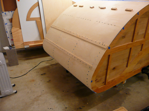

With a little coaxing, I installed 1/8" baltic birch to a 6" radius "roll pan" at the bottom front of my teardrop. The picture below shows my hatch. The lower radius is 10", and I didn't have any trouble bending the ply to install it.
The biggest issue I had with 1/8" baltic birch is fastening it until the adhesive set. I tried narrow crown staples but they "blew through" the plywood no matter how low I set my compressor or nail gun. I ended up using screws fastened through a temporary plywood backer plate.

Hi Tom, that radius looks about as tight as mine! The more I try to make the second design work, the more I feel the first is closer to the mark. The new galley fits right in the first curve too.
Thanks for the pictures! Dave

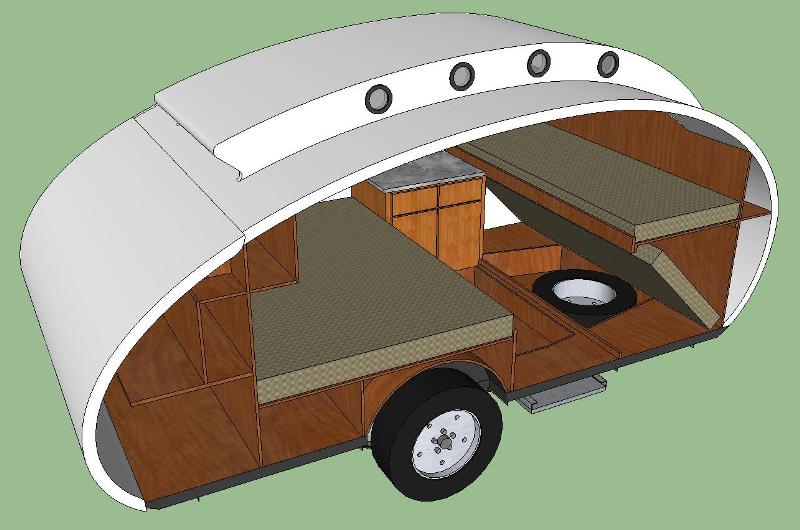

Postby DMcCam » Fri Jan 15, 2010 9:08 pm
Hi again, here's the first design with the new galley ideas, struts and a spare instead of a tongue box. Thoughts?

Postby nevadatear » Fri Jan 15, 2010 9:13 pm
Samn you're good with the design mock up stuff. ! If you want to keep the tongue box, You can always install the spare under the back end of the trailer, like we did (see our album)

spare tire
Postby danlott » Sat Jan 16, 2010 12:14 pm
I like the third design, I would keep the tongue box though. You can mount the spare underneath the trailer or build a drop floor storage box that you could put the spare in. I like the drop floor idea because it gives you even more storage.

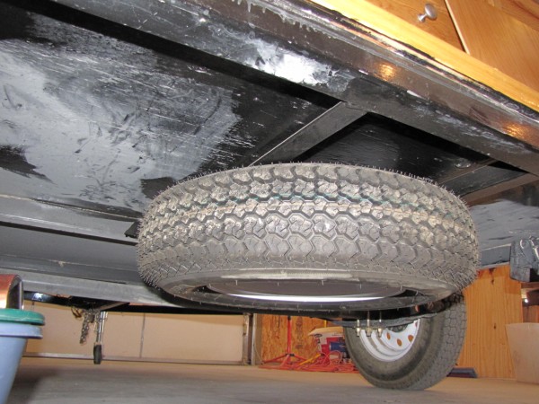

Postby nevadatear » Sat Jan 16, 2010 12:23 pm
dhazard, I like your drop down idea. We left space in the middle for our flat screen tv, but I can see now if we had made a drop down like yours, wide enough for the depth of the TV and made the TV "hinge up",we could have added another cabinet, and who doesn't want more storage space in your TD? So many great ideas out there!!.
Dave, here is how we store our spare, but it was added this fall. For our first few trips we just threw it in the back of the RAV
