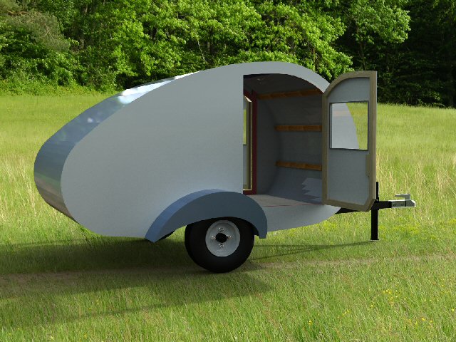

Here at last are the plans for the Pico-Light ultralight that I’ve been promising for the last nine months.
Pico-Light plans
The Pico-Light design aims to be the smallest, lightest trailer that can sleep two people. It is even smaller than a ‘normal’ 8ftx4ft teardrop and doesn’t have a galley or any cupboards. However its size and weight make it suitable for the smallest tow vehicles, including large motorcycles. A detailed weight estimate predicts an empty weight of 280 pounds.

Postby Ageless » Tue Jan 19, 2010 3:58 pm
If you have the budget; you could make it lighter
Honeycomb panels
http://www.panelteccorp.com/html/stockpanels.html

Postby starleen2 » Tue Jan 19, 2010 6:10 pm
Heck how much lighter could it be? Beyond all that exotic stuff - this is well within the relm of the DIY'er :) now who's goona be first to build one? :thinking:

Postby High Desert » Tue Jan 19, 2010 10:31 pm
Thanks for the latest Andrew! It seems to me this would also be a very affordable build, which is a nice bonus.

Postby mikeschn » Thu Jan 21, 2010 4:35 pm
Good job on that Pico Light design, Andrew... It wouldn't surprise me if it got an instant following! :thumbsup:
Mike....
P.S. Can you email me the solid model, I'd like to render it... step is the preferred format... but SAT would work also.

Postby mikeschn » Thu Jan 21, 2010 8:22 pm
Thanks Andrew,
Here's a rough draft. I'll play with it some more this weekend... I'm out of time tonight...
