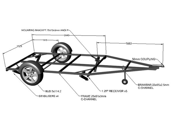

Here we go, starting with the trailer frame, I have some grand plans for the build to be revealed as the story progresses. (Don’t worry I plan on an extensive visual documentation) please don’t hesitate to let me know if you think I’m overbuilding.
TV is a Mazda 3…
A few questions:
*Is a 1683mm (5’6â€

Postby dwgriff1 » Fri Feb 26, 2010 6:13 pm
All of the people with the right answers must be away!
How big a trailer are you contemplating, how much will it weigh and so on? Where are you going to pull it and with what?
The original tongues were less than 24" from the front of the box to the hitch. There are reasons to go longer, and reasons for a short tongue. I prefer short, but I would guess most tongues in this forum are closer to 48".

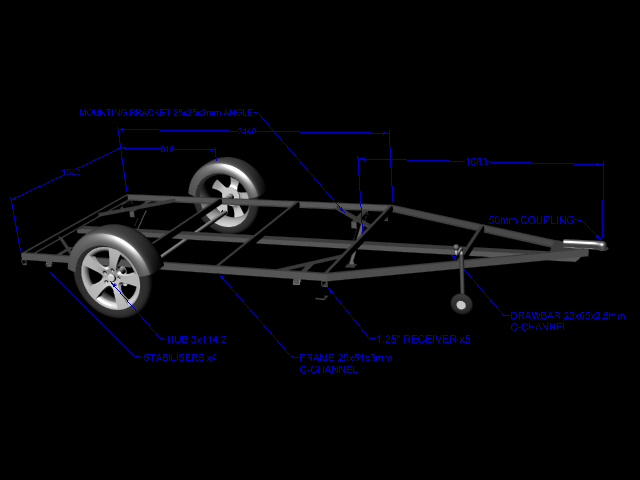

Postby planovet » Fri Feb 26, 2010 7:29 pm
Nice diagram but those blue letters against the black background is just too hard for these old eyes to see. :?

Postby captainkynan » Fri Feb 26, 2010 8:14 pm
dwgriff1, 8'x5', Max weight 750kg (1653lb), pulling on-road with a Mazda 3.
Sorry Planovet, black and white?

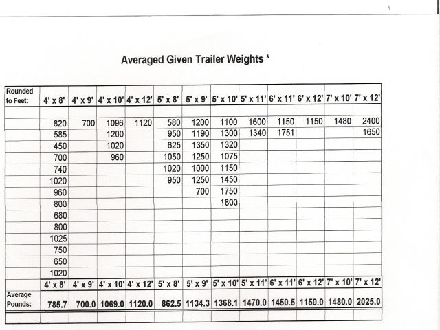

Postby bve » Fri Feb 26, 2010 9:05 pm
That weight puts you well above the average on this chart (which I 'borrowed' from Sharon's album Posted: 2009-11-21 13:56:09).
I don't know the builds that are represented but it would seem you are pretty heavy for a 5'x8'.
What construction materials are you planning? I ask because I think somewhere along the line your calculations may be off - but if you truly think you are going to be that heavy then you probably want to hear from Andrew (angib). Or is 750kg the max tow rating for the Mazda 3?

Postby captainkynan » Fri Feb 26, 2010 9:23 pm
Re-evaluate.
750kg is the Max unbreaked weight for a trailer in NSW and ACT.
I just checked and the recomended unbreaked weight for a trailer towed by a Mazda 3 is 500kg.
As the design progresses I will get a better Idea of weight.
Construction is ply,foam walls and Al roof.

Postby bve » Fri Feb 26, 2010 9:53 pm
captainkynan wrote:Re-evaluate.
This is just my opinion, take for what it is - just an opinion. If you are building a custom frame get your design goals set in terms of the body first, profile, galley features, etc. then you can make a better decision on what the frame 'needs' to be. Quite a few people have built VERY stout frames for very light weight teardrops. Many of the frames rival full sized camper frames which is a bit absurd considering the tear is generally no where near the size or weight of a full sized camper/caravan.

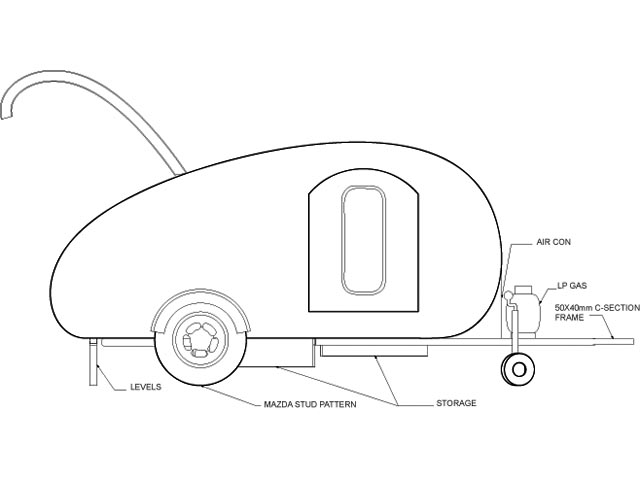

Postby captainkynan » Fri Feb 26, 2010 10:47 pm
BVE, this is an older version of my design.

Postby bve » Fri Feb 26, 2010 11:26 pm
Nice profile, looks a lot like the Cub.
