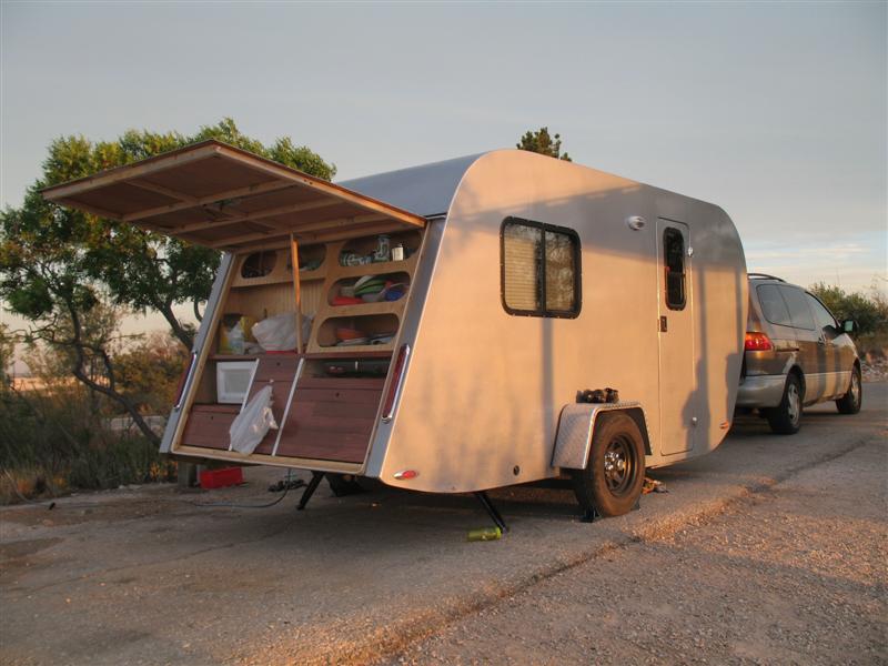

Postby Prem » Thu Nov 04, 2010 3:45 pm
:thumbsup: Nice.
Looks a lot like John's awesome build:
My goal...

Postby asianflava » Thu Nov 04, 2010 8:18 pm
It will be another beauty I'm sure.
Postby doug hodder » Fri Nov 05, 2010 11:02 pm
That is an awesome build Prem...I really like that! I was wanting to do the full radius corners, but that would certainly cut down on a ton of work with the flat sides and a lot of dollars, and a whole lot easier to paint. I've modified some corners and changed the back angle a bit. Doug
