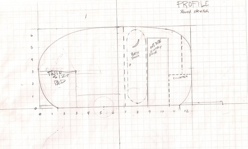

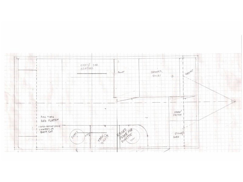

Just wanted to show it off so far and see if any one has ideas or can get some from it. It's really not very unique but it's simple and I like it!
I hope to put this trailer to work as a full time home away from home. I spend allot of time traveling and am tired of dirty hotel rooms and loud smelly roommates..lol..

What's going on in the space under the bed?

Cant tell for sure from your drawings, but it looks like maybe you're making your bed only big enough for one person? You may want to consider a slide out if only for the reason of selling it someday.
I am building for solo use also, but will be making my bed convertible for sale-ability.

Thanks for the compliments! I was thinking about putting the water storage tank and pump under the bed and some space for my duffel bags. I'll probably put an access door on the out side and store the spare tire and my jacks and stuff as well. Hopefully this will keep the tongue weight low. As for the single wide bed? well, I'm not too sure how to do it but I'd like a futon type thing. This way it would sleep two people if my wife was so inclined to come along sometime. I like how the fold out in the squidget works so I'm toying with some drawings on Sketch-up to see how I'm gonna make it come out and not interfere with the dinette and the shelf. There's alway good food for though in this forum....Now,,,how to make the bed work...hmm.

Congrats on getting your design started. And I'd also echo you considering
making the bed convertible for use by two also, if only for versatility's
sake.

Have you drawn the sketches to scale so that you can estimate the overall dimensions? Putting the bed cross-wise may make it quite wide, but perhaps you'll need the width in order to accommodate the shower and other cabinetry.
Mine is a one-person pop-up trailer measuring 11 x 6 and weighing 1,400 pounds. It doesn't have a shower but otherwise it has many of the items you have in mind. This might be a good comparison for you.

Wow! I like that Big Drop! Yes, mine is Similar. I chose the profile I did because the oval shape let me get in more accommodations without giving up decent floor space. I did draw the plans scaled, as to try to get a feel for what to expect. My over all width is 6'5" inside width is 6'2". enough for most people's height including myself; yet still narrow enough to tow easily. I haven't considered putting the bed along the wall but It's definatly an attention grabber. Maybe bunk beds?
Definitely got me thinking! I'll be grabbing yet another piece of graph paper before the weeks out! ...I do like the profile though. It's purdy! :D
