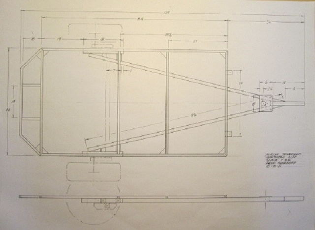

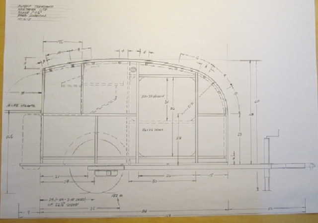

Postby hammett03 » Thu Oct 09, 2014 10:55 am

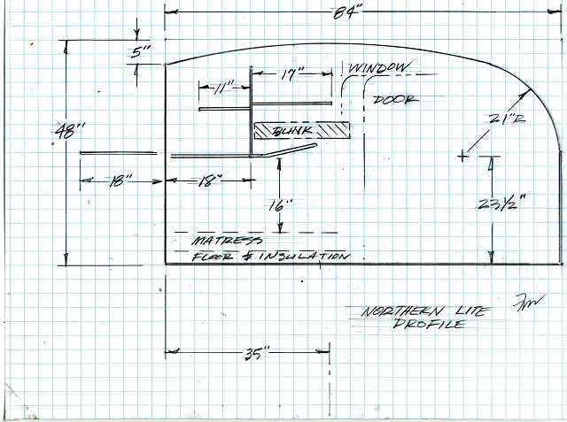

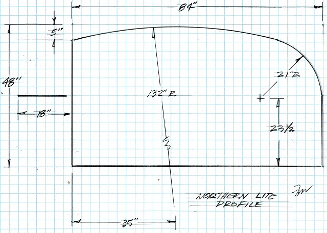

This is the exact shape I have been looking for on my next build! I saw your initial sketch in the first post. Can you give the measurements you used to create the profile? I would love to do this exact shape!
hammett03
Posts: 1
Joined: Tue Jul 05, 2011 12:26 am
Re: Northern Lite Traveler
Postby alaska teardrop » Fri Oct 10, 2014 12:25 pm
Sure,
Be sure to show us your new camper. :thumbsup:
Postby andreuther » Sun Oct 12, 2014 12:18 am
I was wandering how deep you made the galley? I am considering doing a 7 footer with a bunk and I'm wandering how deep of a galley to do. Thanks for your time!
andreuther
Posts: 125
Images: 33
Joined: Mon Oct 14, 2013 3:04 am
Location: Groveland, CA
Postby alaska teardrop » Sun Oct 12, 2014 1:41 pm
Added the galley & cabin shelving dimensions to the sketch.
Went out to the trailer to envision a child's bunk & drew it in approximately where it might fit without encroaching on the adult cabin space.
Keep on designing :designing:

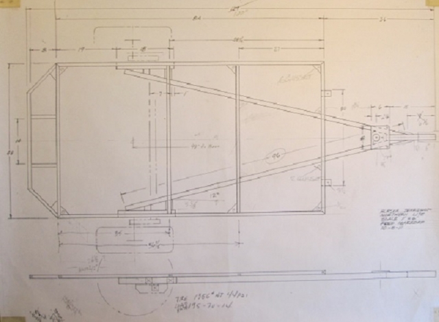

Postby andreuther » Thu Oct 23, 2014 4:26 pm
Quick question: I am planning on having a 4' tongue and your design has a 3' 2'' tongue. With that in mind should I move the axle forward 10'' making it 37'' from the rear? Thanks again!
andreuther
Posts: 125
Images: 33
Postby alaska teardrop » Tue Oct 28, 2014 10:55 am
Andre, I'll take this to your build thread.

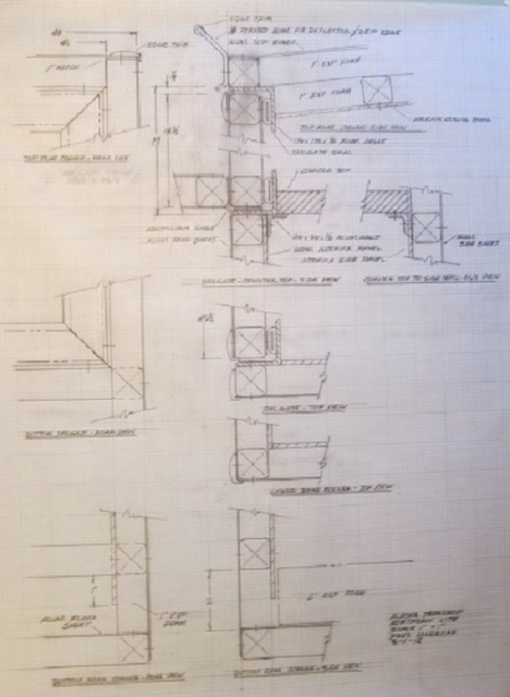

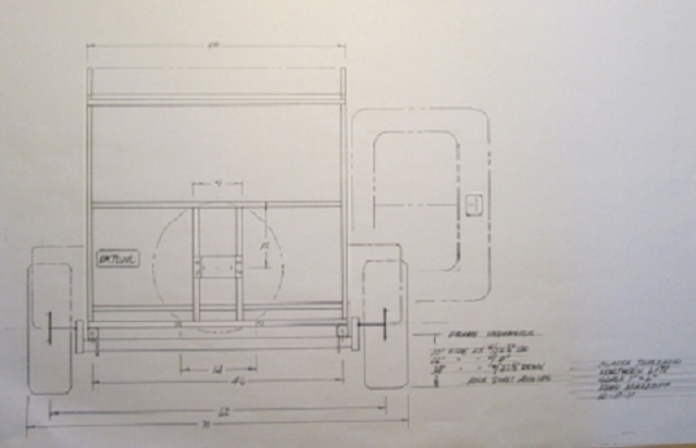

Postby alaska teardrop » Wed Dec 30, 2015 1:51 pm

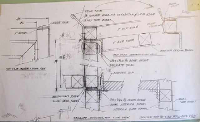

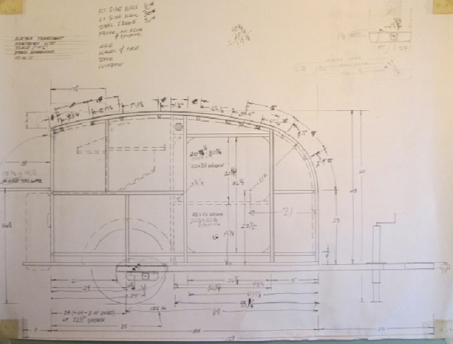

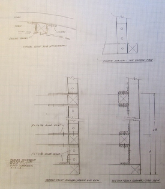

Posting these mechanical drawings for those that may be interested in building this way. They are drawn on 18" x 24" paper. From these I am able to determine how parts fit together, make a materials list, estimate weights and decide which tools to use.
Copies of the drawings are tacked to the shop wall to work from, add working dimensions and make notes & changes.
:peace: Fred

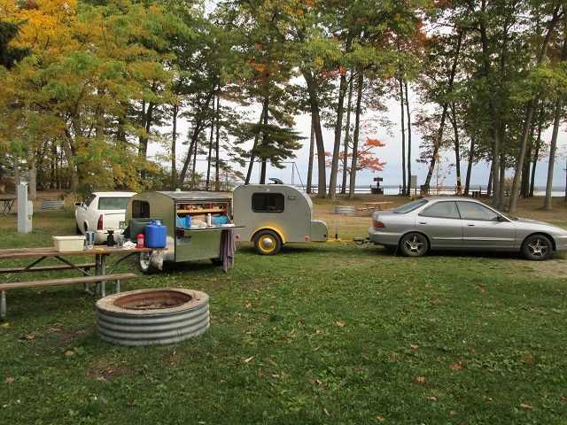

After traveling several thousand miles, attending a couple of gatherings and camping around Michigan I'm very pleased with the Northern Lite. It handles especially well, is comfortable and convenient. No changes made, but have added curtains, interior hanging hooks, Caseydogs simple 110V arrangement and a 12V interior socket.
Nordhouse Dunes, Michigan
Higgins Lake, Michigan
Cross Roads America Gathering
:peace: Fred

Postby Junkboy999 » Fri Jan 08, 2016 2:40 am
Great Pictures.
Nice to see yours and Stacie's TD next to each other.
Junkboy999
Posts: 1259
Images: 52
Location: Wichita, KS
Postby alaska teardrop » Sat Jan 09, 2016 1:48 pm
Thanks, Terry, Good to hear from you. :shake hands:
Yup, Stacie is a joy to travel with. :vroom:
Are you building? Or simply enjoying your first? IRG ?
:peace: Fred
alaska teardrop
Posts: 1085
