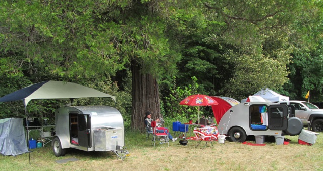

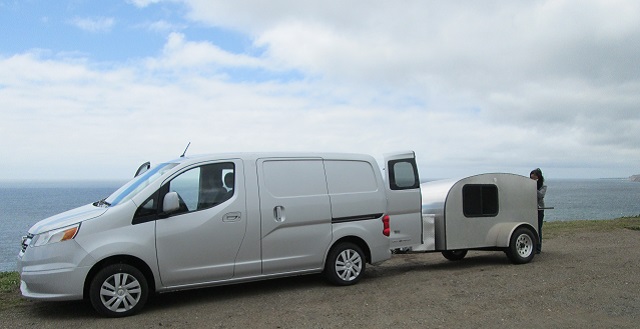

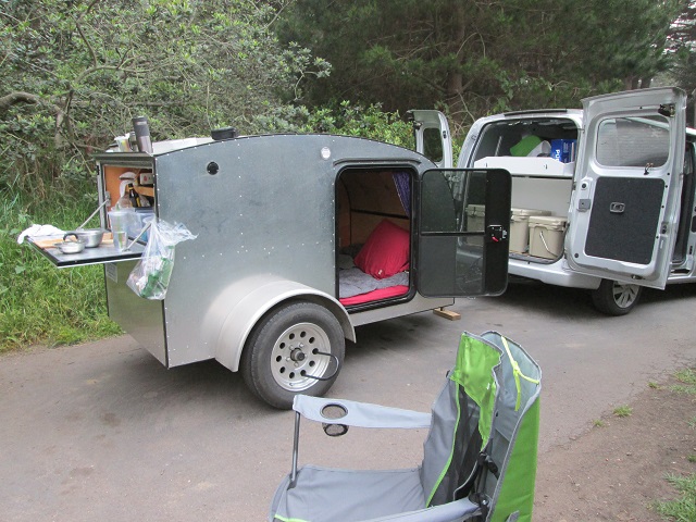

Thank you all for the compliments. Well, it's been awhile. Time for an update.
The Northern Lite has traveled several thousand miles, including a seven week trip of western states, the Pacific coast and the last Redwood Gathering. No issues except a flat tire and no changes made to the trailer. I have added a tongue box and a 30 amp AGM battery with AC charger.
:peace: Fred
