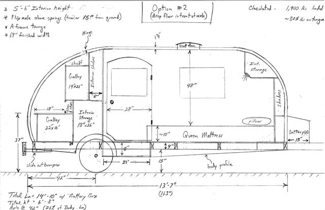

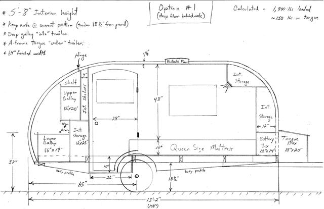

1900 lbs finished trailer wight is doable. But you will have to watch your weight on each component.
My trailer body is 12' long, 5' tall and about 5½' wide. Came in at about 1900lbs. And I would not even consider taking it out on the road without brakes.
Like Dan said, Option one is the better choice. Option 2's tongue weight is just to much.
