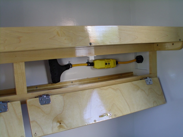

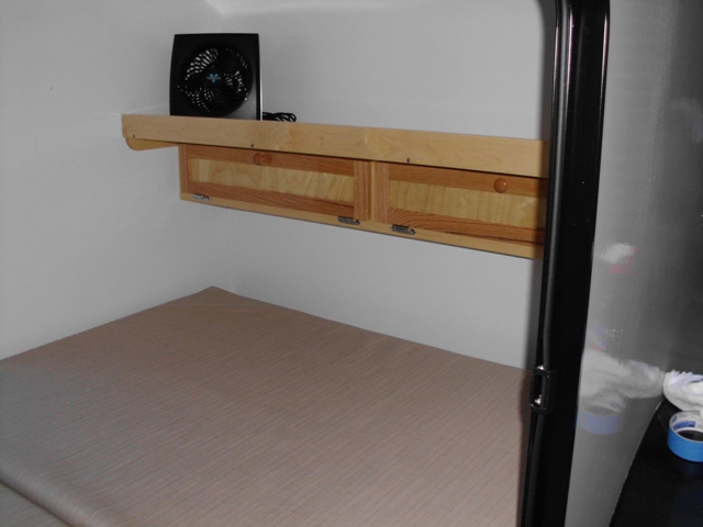

The alternative for those hot nights (but you will need shore power to make it work) is my cheap and simple electrical with a plug in fan.
I will be the first to admit that if I had the know-how and the confidence to do more complex wiring, my teardrop would probably have a disco ball hanging in it. So I am not selling it on the premise that it is the best possible solution, but it is an alternative if you want fast, cheap and easy.
Others have used this simple system as well and most have said they found it to be fine. Fortunately for me, I am on the East Coast where most campgrounds have electrical available. If you plan to boon dock a lot, or using campgrounds in the west where electrical is less common, this solution will probably not work for you.

Yeah, this simple electric system is the basis of what I am going with. I was just going to run three additional plugs instead of just having the one splitter. I am completely comfortable with that.
