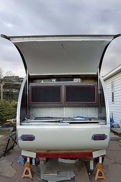

I'll say details! Keep thinking of more and more things I need to fidget with to get just right. Not to mention doing the sleepng area wall finish yet. :worship:
It is aluminum trim and the counters are galvanized steel I found in sheets at HD for about $11.00 for 3x4. Look crappy to start with, but I am taking the 000 steel wool to it and doing small circles and moving "up" to fine scuff the surface. My right shoulder is going to look like Popeye's forearm before I finish that. :wacky

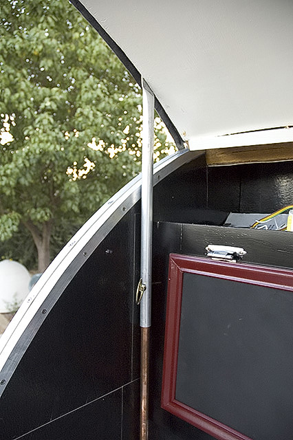

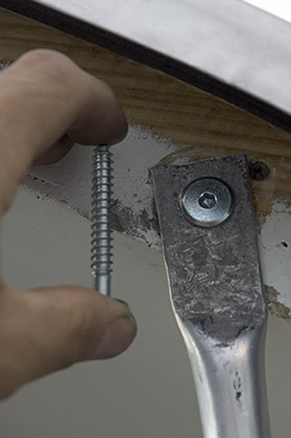

Finally got a solution for the galley hatch props. I had put T-nuts in and bolted in an aluminum/copper system (someone's idea-WORKS GREAT). The hexbolt decided to catch and scratch up the interior. So yanked em and doweled the holes. Found some Furniture Screws (picture here) and put those in.

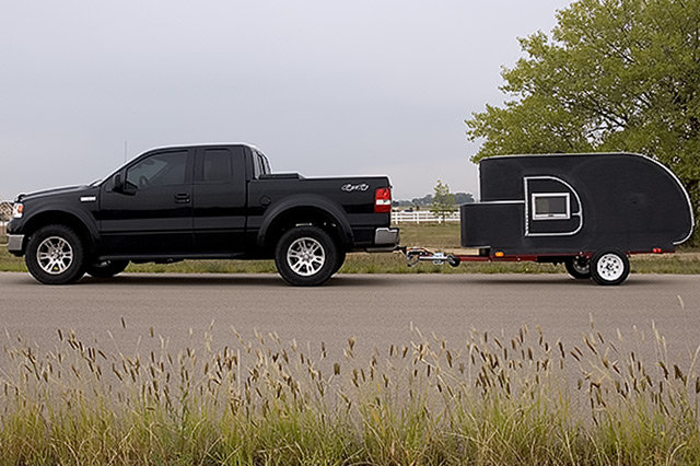

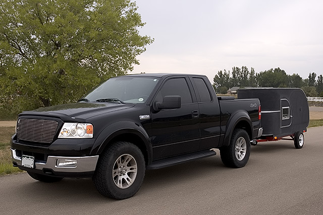

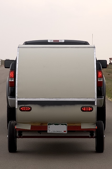

Outta the yard and behind the truck. Lots of things to finish, but she is campable now!!
Rear View Side View Front View
Need to find the 15" tires and rims, will need shorter drop on the hitch also.
Interior to be finished when possible. I do have to repack one of my bearings and hubs. Just going down one mile on the road at 45mph she warmed up beyond accetable to me, while the other barely even warm.
Need to get the DiamondPlate "skirt" I plan to go around the bottom and front, and of course final paint (that is all auto primer) to match the truck.Image
