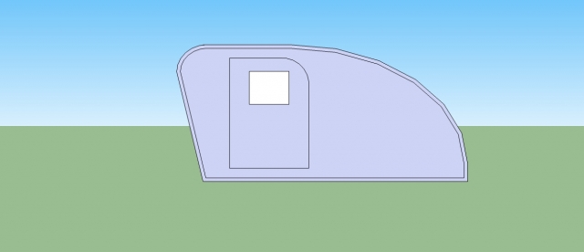

I have an idea for my first build and am actually moving along with the plan, but thought I would pop up a picture of my profile and see if it looks like a viable design. I wanted to do something a little more unique than the flat up front. I'm planning to skin inside and out with 1/8 ply and I figure it ought to bend for the curves desired. The body will be 5' X 10' at the floor and 5'2" tall. The full frame will be enclosed in the height, as the outside wall panels will skirt to the bottom.
Anyway, here is the profile. Please critique.
gallery/image.php?album_id=3685&image_id=124465

The curve in the front may be a little small to get the wood to bend around. Just a thought.

That's really my only fear. Like I said I am using 1/8 for the skin so I hope it will do the curve I am shooting for. Any input from experience would be greatly appreciated. I could also look into a piece of bending board for that area. I wanted the raked front and a closet space in the front for some hanging stuff. If the curve is too severe I will consider broadening the radius.
Input please?

Mitch:
You're thinking out of the box and that's good.
I'm curious about the 5'2" height. The interior of my 'drop is 46" high (minus a 7" mattress) and I have plenty of room to sit up and dress etc. Of course with 5'2" you can't stand up and I'm wondering what you're going to use that extra 14" of ceiling is for?
Also, rolling your bottom front in, you'll lose quite a bit of floor space. Maybe a foot –and 12" is a long ways in a teardrop.

Actually the 5'2" is a bit deceptive. That is the outside height from the bottom of the skirting to the top of the roof. These dimensions actually produce an interior ceiling height of 4'7". I really wish I had an actual teardrop to "fit test". I have only seen pictures.
Regarding the pitch of the front. I'm not taking away floor space, but actually adding space to the cabin beyond my floor dimensions.
I think I need to find some local builds and see a real deal.

So, what are the feelings about bending 1/8 plywood over a 24 inch radius? If it is impossible or even improbable, then what is a reasonable radius?

there are different types of 1/8" ply, the "wacky wood" has the grain in the plys all going the same way, allowing a much tighter bend, I believe the tightest they expect you can get is 12", good luck

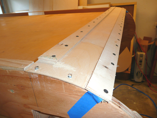

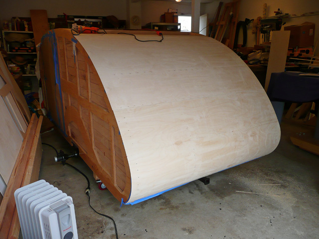

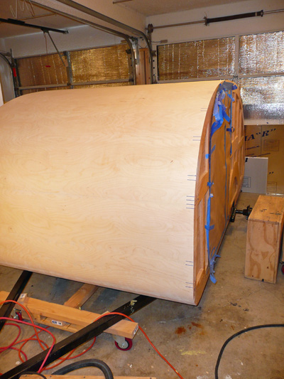

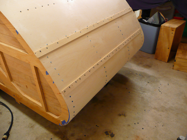

Postby aggie79 » Wed Sep 24, 2014 10:44 am
I like your design! If you use good or better quality 1/8" plywood, you should be able to bend it to your 12" radius.
Sorry for not getting to your post earlier, but I skinned my teardrop in 1/8" (3mm) Russian Birch plywood. This is a standard, good quality plywood (but not as good as Baltic Birch.) It is not a bendy ply.
With persuasion, I was able to get it to bend around the 10" radius at the lower edge of my hatch and rear roll pan.
This is picture of the roll pan. (At the time I had my teardrop flipped upside down on its roof so I could do work on the bottom of the teardrop.)
Here's a finished look of the hatch prior to skinning with aluminum:
I also use the same ply at the lower front roll pan of the teardrop. It has a 6" radius. I will say this is quite a struggle and wouldn't recommend going to that tight of a radius.
I did not pre-bend the plywood or soak it in water prior to bending. The plywood skins are glued into place with PL Premium. You'll see that I used lots of temporary fasteners and wood backers to spread out the pressure of the fasteners. After the glue set, I removed the fasteners and filled the screw holes.
