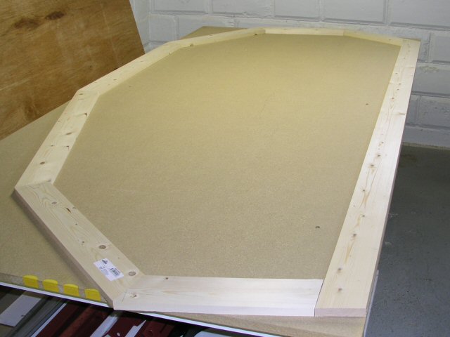

Postby spchytr » Thu Oct 26, 2006 10:25 pm
I was wondering if I could get dimensions of the frame pieces for this, I would like to build a 'squared off' tear that still has a somewhat teardrop shape to it, and something like this seems to be an easy way to do it.
The rough framing is going to look like this...
Then I'll use a router to cut it down...
