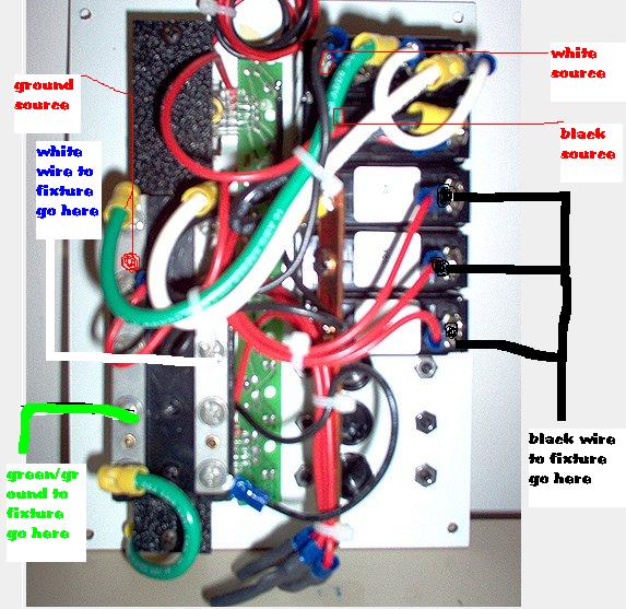

Hallelujah...and HELP! My panel arrived.
Anything electric, AC or DC
Postby madjack » Thu Dec 29, 2005 12:36 pm
Ira...for your fixtures...
...the green or ground wire goes to the silver bus bar on the far left...
...the white or neutral wire goes to the silver bar to its immediate right...
...the black or hot wire goes on the far right of the breaker where the red wires are attached(the red wires power the LED indicator lights)...
...for your source...
...on the main breaker with the black wire jumping to the copper colored bus bar...the main black wire from your source should go to a screw on the left side of that MAIN BREAKER(second breaker)
...the white wire from your source should goto a screw on the left of the top main breaker
...the ground or green wire from your source should goto the silver bus bar on the far left
Postby Ira » Thu Dec 29, 2005 2:14 pm
Okay, okay, I THINK I got it Jack:
So all of my white/neutral line wires go to the same SCREW? And the same for the ground wires?

Postby madjack » Thu Dec 29, 2005 5:00 pm
Ira...they all go to the same "BUS" which has 6 screws onit and the same for the ground side "BUS" which also has 6 screws onit...as you probably know...one good screw is as good as another

Ira I think I would have an electrician look at it before you plugged it in. :SG

Ira....MJ has you steered in the right direction. :thumbsup:
