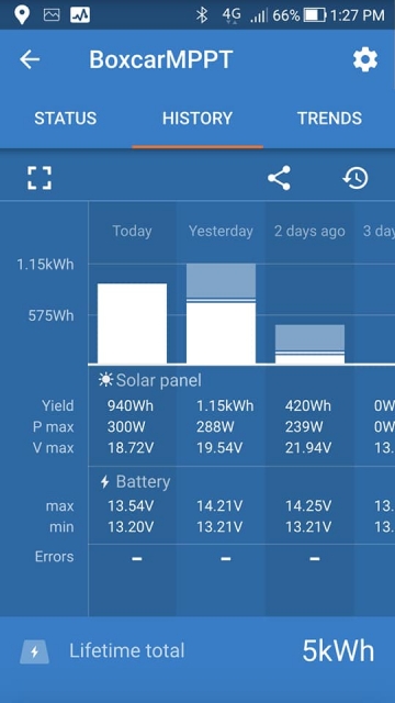

bdosborn wrote:
iconicflux wrote:I'm figuring a use of about 4.6kw/day if we wanted to boondock completely off-grid.
Wow, that's a lot. We usually use about 1kW-hr max a day, and that's with two compressor fridges. Are you using electric cooking? Here's my usage while boondocking for a couple of days.

I use a Tundra 12V upright fridge and a Dometic CF-40. I did some energy measurements awhile ago:
http://tnttt.com/viewtopic.php?f=2&t=46331
I was surprised by how much a laptop used so I built a small PC using a Asrock j5005 mini ITX board. I also use a travel router that runs off a USB port of the PC. Both of them draw around 24W in use. The PC runs off 12V as does the TV/monitor.
https://www.amazon.com/gp/product/B07GBXMBQF/ref=ppx_yo_dt_b_search_asin_title?ie=UTF8&psc=1
That was something I emphasized when I put the system together, run everything directly off 12V. Even my wife's CPAP runs 12v direct.
